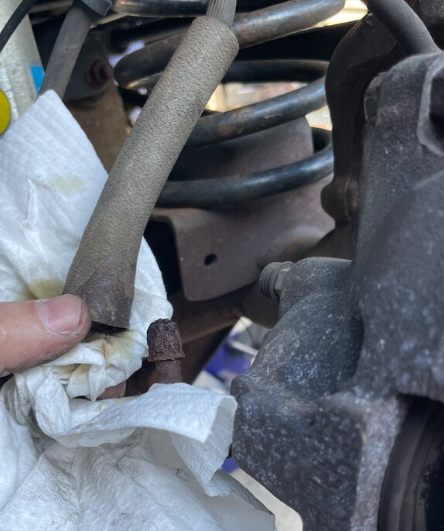

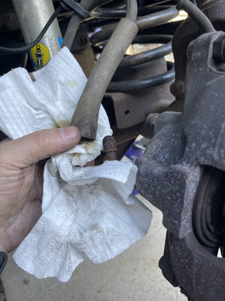

Well this seems to have been the issue. But wasn’t soft rubber but severe corrosion. I ordered brake lines off your recommendation, thank goodness. When tightening down the caliper bolt I hit the tubing and broke the brake line, with little pressure. The other side broke almost as easy.
It appears the brake line was not allowing flow back from the caliper causing it to stick and build up heat. See pictures but I think the brake pad was breaking down.
