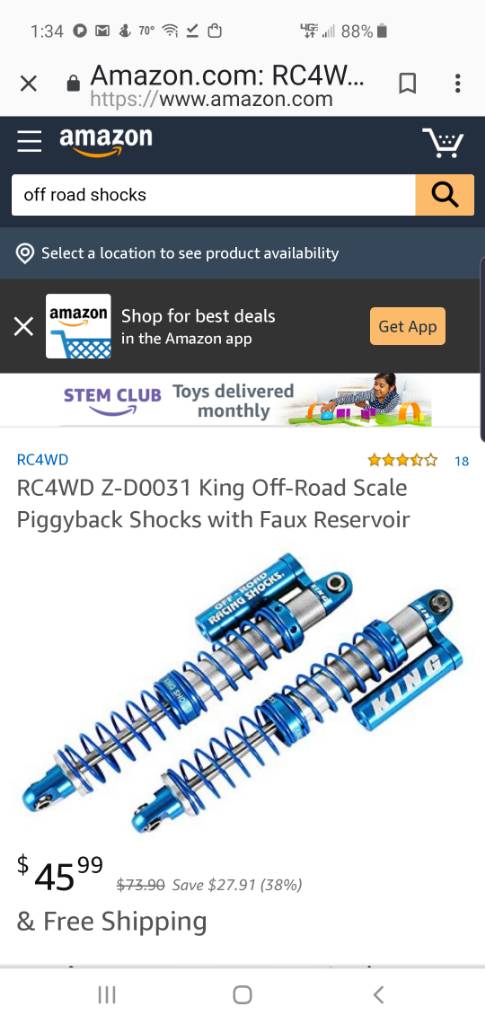

Not to hijack your thread RQ but started looking at tuneabke shocks and this came up.
LOL, didn't know you can get a Faux reservoir.
You've got me wondering if I could improve the ride on my 5.

Cant tell if you are joking... those are probably a little small for a jeep.
Two thoughts in one post, funny you can get the faux reservoir.

Yeah, no real point in having a real reservoir on a r/c crawler.
