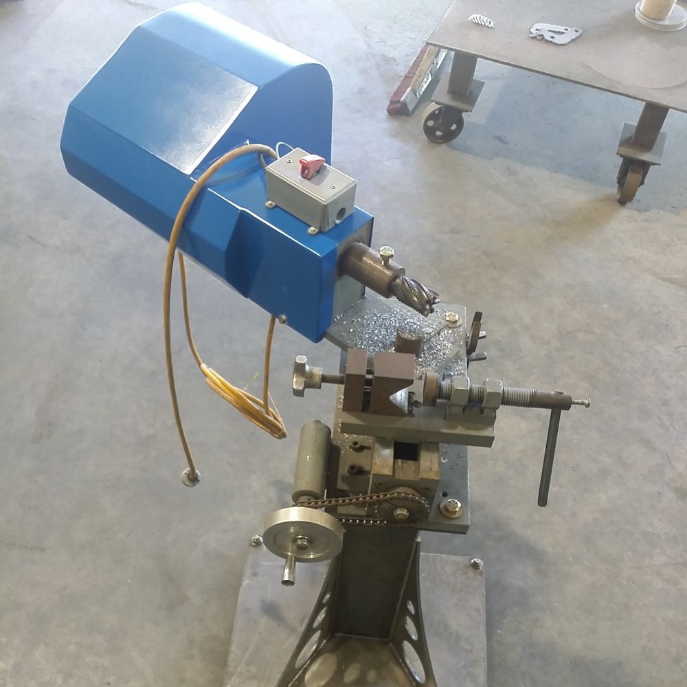

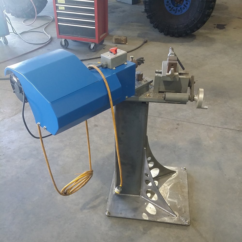

My latest creation. My dad built and machined the majority of this tube notcher a few years ago for a guy and he no longer needed it. So..... it became mine I added a larger motor, built a nice stand, geared it down a little more and built a nice cover over the motor and drive system.

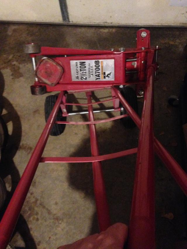

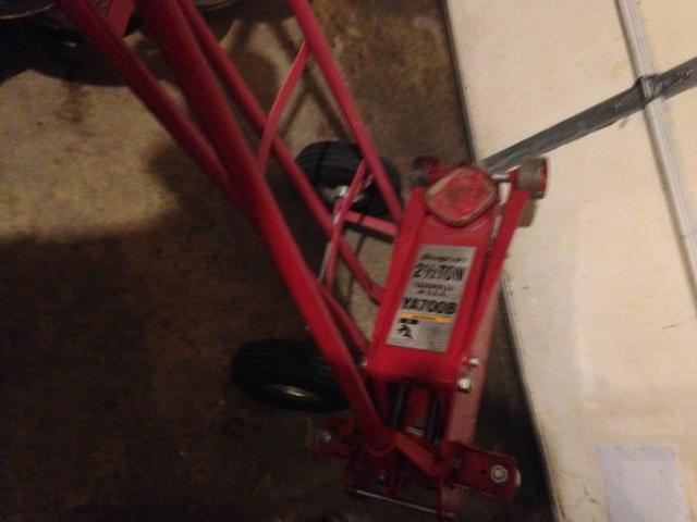

I also work some on my gravel drive and parking area. I use the hand truck to move my jack to where I need it. The hand truck always stays beside the jack.

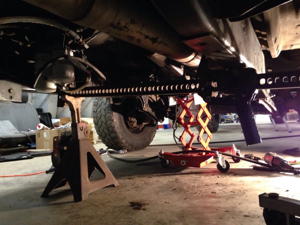

18" pipe and a strong right leg! Lol. I promise anyone that trick is quicker and easier than beating that crossmember backwards.
The two I've pulled required a porta power and close to two inches of spreading, you must have a very large hammer. Bet it was fun operating that hi-lift with a ft of clearance.
I don't know what yall are doing different but a 2lb sledge slide the crossmember up until it hits the floor pan knock forward then down to align the holes. Some were more difficult than others but I guarantee it was in there faster than you could get a tool or pipe wedged in there, Some people just got it I guess. :D
I used the pipe in the jack handle for leverage. One click and I can remove or install it with my hands. I've done it with a porta power and a house jack, the hi lift was the quickest and easiest for me.

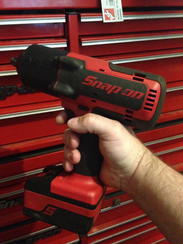

Another tool I hope to never be without at home or away from home is my Snap-on CT7850 cordless impact. Lithium batteries, 650lb/ft trq and no hose. Goes with me everywhere with 3/4, 13/16 and 7/8 Snap-on deep sockets (lug nuts) and a 1-1/2 deep for trailer balls. If I had to pick one favorite tool, this would be it. It even has a super bright LED light for those late night tire changes LOL

Battery life is phenomenal. I know guys who use one in the dealership now instead of a airgun, and they have air hoses everywhere.
I have removed and installed my 32 lugnuts multiple times in one day on one battery.
The one MarsFab has is no slouch either. It changed the game with these type tools when it came out.
