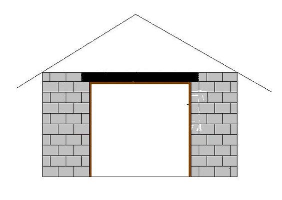

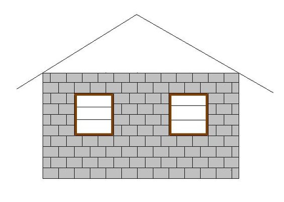

the shop that i have at my house is a block building. the door is in the wrong place. I want to block up where the exsiting door is and then move it to the gable end.
here are some drawing on how i want it:
what is there
what i would like to see
How hard/ how involved is a project like this?
How do you get the header in place?
How do you support the building while there is no header?
How do you calculate what type of header to use?
let me know what you think.

the right way is to tooth-in the new block, install a good sized lintel (header) and door framing, and finish up the block.
It doesn't look like the block goes up much higher than the door, so you wouldn't need much of a lintel cause it wouldn't have to support much weight from just 1 row of blocks.
for 8-10' doors, a fairly standard lintel would prob. be at least a 6x8x3/8" angle with a minimum of 8" of overhang on each side on the block.

If the trusses are going from left to right, that shoudn't be a load bearing wall, so you shouldn't have to worry about supporting any weight with the lintel. This way, the lintel will be mainly for support for a roll up door. If you don't have a roll up door, you can use a couble of double 2x8s as a header to frame out the door, treated of course. It all depends on our choice of a door.
I think the hard part will be properly blocking up the existing door. You'd have to support the rafters while you remove the existing block and lintel, tooth-in new block all the way up to the rafters, then remove the support for the rafters. If you decide to leave the existing lintel in there, you'll have an easier time, but it won't look as good in the end. It all really depends on the final look you are after.
I understand what you are saying about the building. I wouldn't want to give definative advise on something that i haven't seenbefore either. I think that with the existing door I would leave the header in place and just block up to it. I know it wouldn't quite look at good as it could but it is a woodend header that takes the place of the last row of block.
when looking at the diagram the roof line on the left actually goes out/down another 3 to 4 feet. Making the enterance to the shop only about 7' tall. As for the door I'm hoping to go for a 8x10' roll up door.
One of the main reasons for moving the door to the other side is so that I don't have to drive all over my yard to get into the building. It is set up in such a way that it isn't a straight shot to the door. By moving the door to the other side I will be able to lessen the impact on the yard and if it rains this year I'll actually have some grass.
