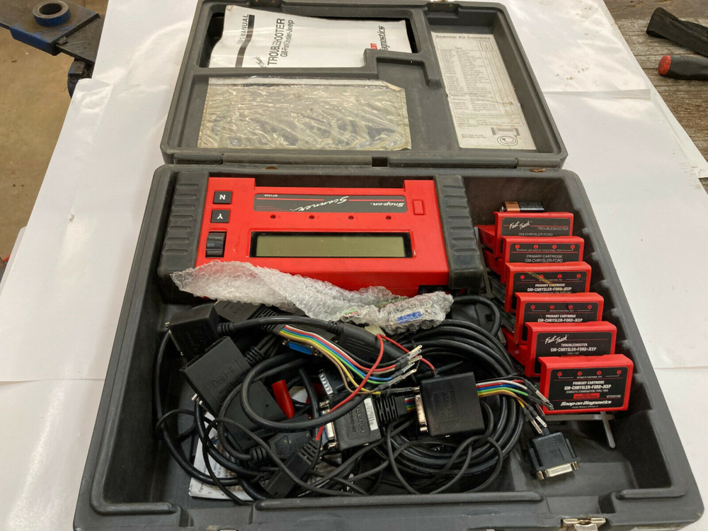

Snap on MT 2500 aka Brick... Will do all vehicles with OBD 1and OBD 2 up to 01 IIRC with the right cartridges and keys. About $200 - $300 on ebay.
Another thing I didn't know I needed.
Watch eBay they can be found cheaper. Mine was $150. Click wheel did not work. Opened it to clean it and found it unplugged. I bought it for the MJ when we had it. They read live data on the old Renix system. Great for diagnosing problems on the older systems.
