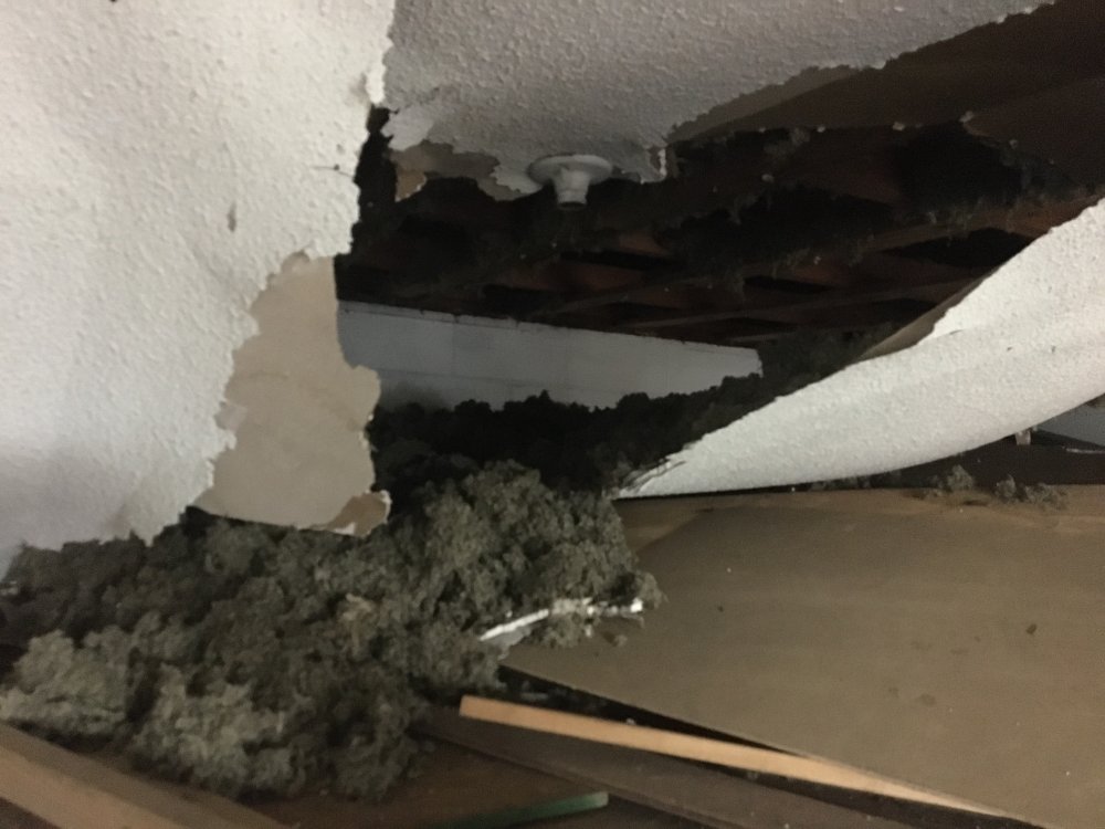

So last year had a leaky roof and thought that was why my roof in the shop failed. Apparently not had more fall while I was gone to Harlan. It’s for sale so don’t want to spend a lot of money on it and I really don’t want to hang Sheetrock 12’ in the air. Suggestions? I was thinking thin plywood.
If it's a shop, and the stuff in the rafters isn't terribly unsightly, just rip all the drywall out...

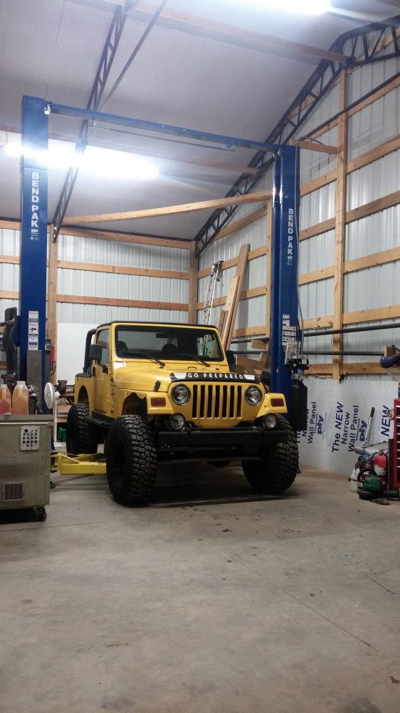

I used Thermoply on mine because it was cheap (like $4 per 4x8 sheet) and white. Found it on Craigslist. It technically could be used as wall sheeting, but houses built like that are the ones that blow over in strong storms.
They have different thicknesses, and what I used was about 3/16" and light enough for one person to easily hold up while someone else screwed it in. I may have even done some by myself, but that was 6 years ago.
Here's a pic of it on the ceiling and a couple leftover pieces leaning against the wall.
Here's a pic of it on the ceiling and a couple leftover pieces leaning against the wall. View attachment 321622

Be careful as I would guess you have another leak.

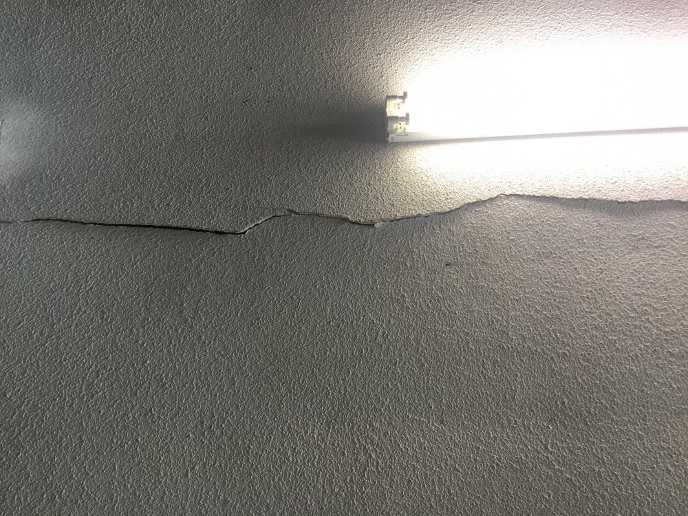

Fairly certain that sheet rock was put up in 1966 when this building was built. 90% posative it has just pulled through the screws and fallen apart with it's age. There are no signs of a leak. I'm certain with the rain falling now I'd see some water up there....
That insulation up there does look old. I assume some sort of blown in stuff.
My house was sheathed with Thermoply in 1989. Still looks new. It's almost structural, but can hear the house racking in the wind a bit. It's getting gone when I replace the siding and the windows, mostly because I hate it and there's not a single penetration with any air sealing, and you can't attach anything to it. If you used red Thermoply, it's 0.1 inches thick, and the blue is about 0.125 inches (extra stout! :D). The green non-structural is thinner than the red (they're all white on the backside). You should see the shit I had to do for blocking behind it when I started replacing the porch/deck lights.
It actually is a great material for doing closeouts on kneewall/attic insulation, because you can tape the seams like ZIP system, and it's cheaper/easier/lighter than drywall. And it cuts with a utility knife. That's what I like in a structural sheathing; extreme notch sensitivity. Also makes a great floor covering, like Ramboard.
I'm putting 11/32 sheathing on the ceiling of my shop currently. Painting it white outside and hanging it myself. It is a shop so doesn't need to be perfect so since it is light and cheap I just used that. Screw finishing sheetrock with a full shop.
Looks like Lowes no longer carries Thermo Ply local to me. Is it foam board? I guess when I have time I need to go walk the aisle and see what I can come up with. There is no way I'll re sheet rock a roof in that shop. It's heated so I do want to do something before winter. I'm not looking forward to all that insulation coming down either. I'm thinking I'll fix the area that has completely collapsed and see how it goes.
