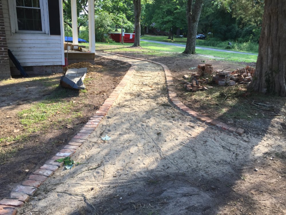

This is what I did. Front sidewalk was concrete and need to be replaced.
Used recycled bricks to edge the sidewalk and used 78 stone in the sidewalk. Used a tamp to consolidate the stone and it was good and hard and looked nice.
Pics are through the process but you get the idea.
Total cost was about $100 for the 78 stone and my time.
