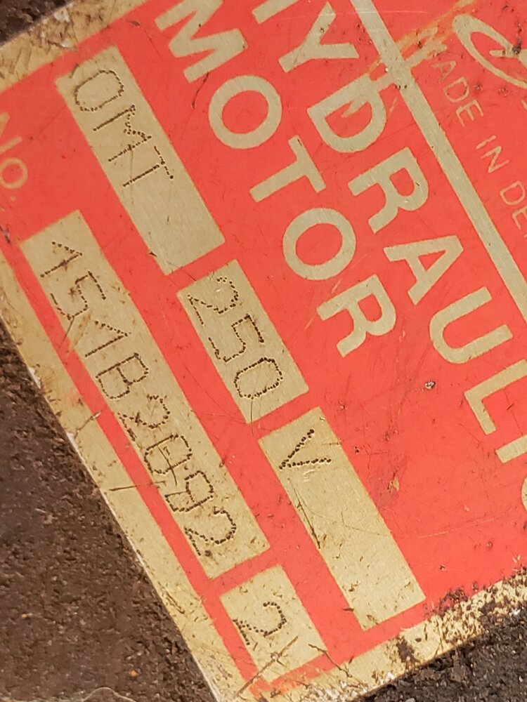

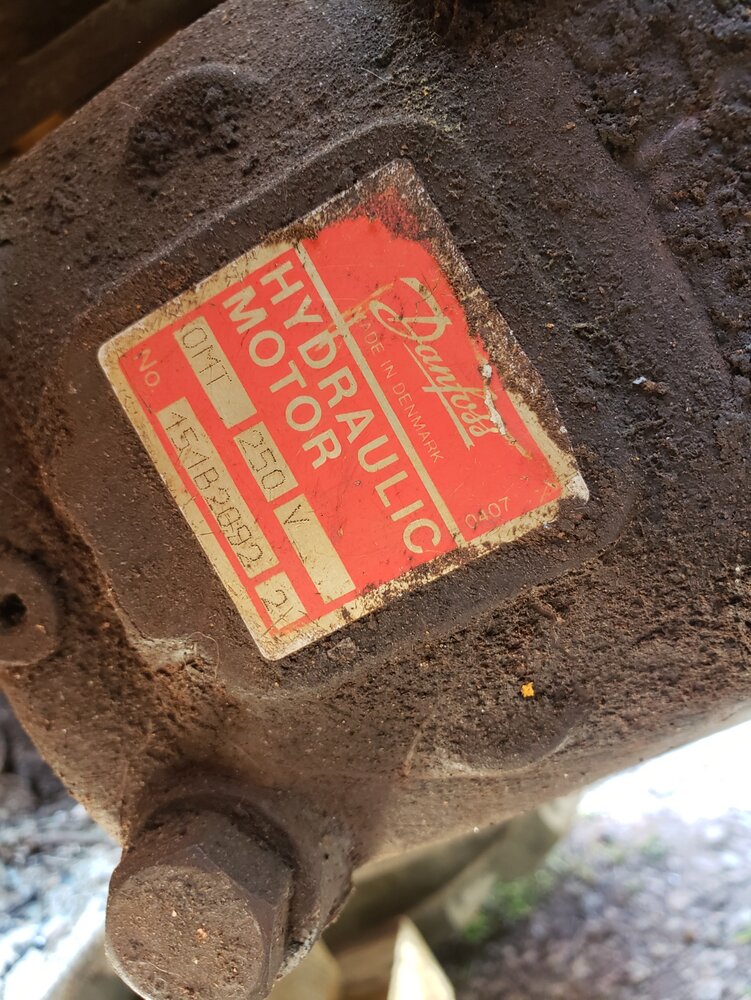

and I found out the drive motors are Danfoss which I'm pretty sure that is a common motor...still trying to locate a seal kit/rebuild kit since a new unit is $900 figured if the rebuild/seal kits are cheap enough, I'll just redo both motors.
Danfoss OMT 250 V
No 151B2092 2

$900 is actually a really good deal.
Yeah when i read that, I know what I would do. Heck, the leaky drive motor for my zero turn is almost twice that!
95% chance there is more to the issue than a seal kit. $900 is actually a really good deal. Should be very easy to find a danfoss omt seal kit though.
i know lol, i guess I'm basing it off the bobcat guys hoping it's like their issues when this happens. I guess the seals go bad and it "bypasses" fluids therefor it's slow?? Idk, I'm actually trying to find someone who works on these to come out and pay them for 1hr to go through the whole machine just showing me/telling me how the whole system works so I can better understand what i'm looking at, what does what, etc..
(I think they're 900 unless I was looking at the wrong motor lol)
