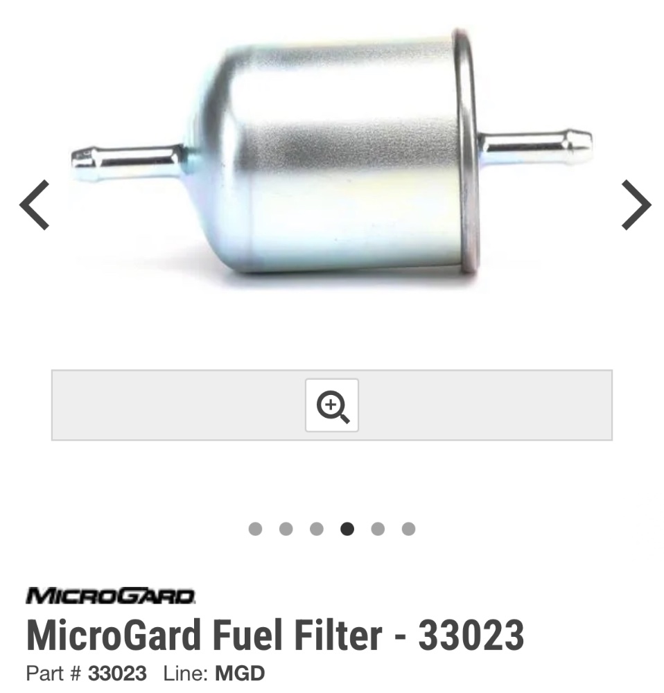

You need a 100 micron screen filter between the pump and tank and a 10 micron after the tank
Here’s a good orielys part number for a cheap 10 micron

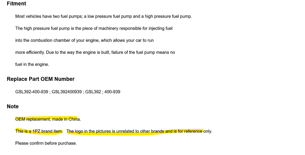

That fitech pump is just a knockoff walboro GSL392 or Bosch 044 which are really common style for custom setups I use one from eBay that claimed to be original walboro (read Chyna in your best trump impression) . It’s better to get one that already has the fittings, a foam sleeve to quiet it, and a pair of mounting straps.
I’d carry a cheap spare before I bought an expensive one. They’re all knockoffs anyway
At least they are honest if you read far enough in the description:
