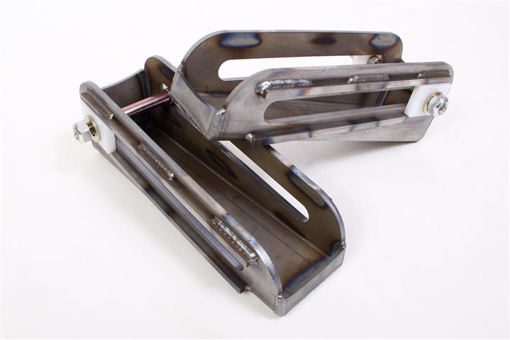

    Since leaf spring slider boxes have been around the off-road world for quite some time now, I'm sure most folks have seen them on the trail and may have even owned a set. This next rig I build will not be a buggy like the last rig was, but rather a simpler, more comfortable functional rig but still packing LS power and will still get a set one tons. I'm wanting to keep it leaf spring f/r for now and stick with a combination I had years ago and loved, which was stock YJ springs up front and XJ leafs in the rear. Most slider box applications I've seen in person or elsewhere have been in the rear of a vehicle. Makes sense. But how would they work in the front, with factory jeep spring configuration and SOA, and is there a reason nobody runs them there? I'll be out boarding my front springs to accommodate for the Superduty 60 38" spring pad location so steering box clearance won't be an issue that I can foresee. Is there any reason not to use them for this?

    @HAPPY has them on the front of his J truck with tons. @BUCKEYE PERFORMANCE INC. made the sliders and built the rig. I am not sure what springs are on it. They seem to work perfectly. Maybe they will chime in with more details.
    I almost put a set on my SOA shackle reversed Cruiser, but had some free shackles that I used instead.

    Who's the guy on here with the SAS Ranger? He's got sliders up front too. I'm pretty sure there are a few more guys with them as well, just can't think of any names right off hand. They seem to work great and all of them I've seen have been at the back of the front leaf spring.

    JC had some on his yj. I don't see why the slider would work any different/worse than a shackle in the same location.

    I'm going to be buying a set anyways. I'll mock em up in the front to see how they look and if nothing else I planned on running them in the rear.

    Im planning on running them on the front of my k5 just so i dont have to dick around with the factory shitty shackle hangers. When i was researching them, everyone loved them but its just not widely used

    Right now I'm torn between doing a slider box in place of a shackle on the front, or using a slider box in like a shackle reversal setup. I've always done a frontward facing shackle on a leaf spring front suspension. Not sure if I want to change up a good combination.

    I prefer that too because of the change in pinion angle with the shackle on the back. But with slider boxes is there no change since the rear of the spring doesnt move vertically and just horizontal?

    They are suppose to have a slight angle in travel to them. The boxes I'm looking at are the Liquid iron industries product. They are made to mount to the bottom of a flat horizontal frame section but have the proper movement angle built in.

    Better picture:

    Still not the huge arch a 7.25" shackle will have

    Nope. I'm looking at doing a 5" or so shackle on the front of the jeep, if I did. Looking at it now, it looks like it'll be tough to package the boxes in my application being there's the extra meat hanging off the front. But on a positive note, slamming a shackle and vending/breaking a main leaf wouldn't be a concern. When I pick up a set to do my rear I'll see how they look. If its doable, I'd buy another set.
