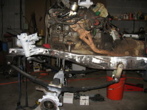

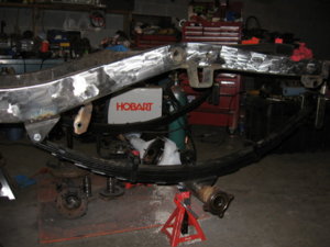

Shot of the trussed, strapped, and shaved 85 front. I have a welded hp for it with a factory 4.10 gear. Those are the trail gear 3 inch springs plus their complete sas kit for the front. The frame is from a 87 runner.

I drilled and tapped my own steering box. The motor is a 85 22re rebuilt to factory specs. I hope to add a cam and header later on.

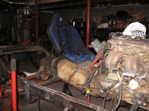

Sweet suspension seats, used of course. The tranny is a 85 yota auto with inchworms adapter to run mini truck cases. The front case is a 23 spline 2.28 case, the adapter is TG's new 23 spl adapter with what I think will end of a 23 spline 2.28 converted case till I try it to see if it needs more gear. I spoke with several ppl about the extra gearing and what they thought and after talking to my buddys bjack and 35xj, I think I'll try the stock geared dual cases before I jump into a 4.7 gear set. The rear case in it is 21 spline now, but not for long. I'm working on the cross members now. The tranny crossmember will also support a yota carrier bearing shaft to feed the hp front. I build dual yota cases, do 23 spline conversions, and low gear set installs if anyone needs that kind of work done.

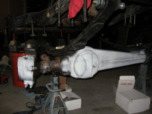

My plans for this weekend is to finish and button up the ifs rear axle, it is also shaved an inch, diff strapped, 4 cyc third welded 4.10 gear. I also plan to do my own knuckle stud conversion on the front axle, build my own creeper gussets for the front and start frenching the rear TG spring hangers for the my 3 long travel rear springs.
Pic of the prepped ifs rear axle and springs and the hangers tacked in, the spring pads on the axle aren't tacked yet cause I need the chassis on it to get a better idea of how the springs will settle and where to mount the shackle hanger. I can't build the rear frame cross member till then either.

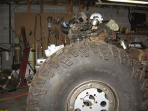

pic of the front approach with my 42 iroks on it. :lol: I plan to run a 37 or 39 irok but I like the look of the 42 if it had enough power. May have to try it just to see...
is the fuel injected motor legal now?
Yea, carb, efi, propane are all legal now. So are regeared diffs and any DOT tire, sticky or not. Oddly enough you can't run rear disc brakes, cutting brakes, driveline disconnect, or forced induction of any kind.
bjack your rig would be even more dope with the 42's on it, and we can't have that, I would have to buy/beg/borrow/steal it for sure then, with the shaved diffs it really does look like portal axles, I bolted the up onto the rear for a look see, they looked awesome.
your hangers are on backwards....
yea the rears are only there to hold place till I french the frame a little. I'd like to sink the new hangers an inch up into the frame. Nothing is welded for sure yet, that is why it's only tacked if you'll notice that to. On the front shackles I think I'll have to move the frame insert fwd an inch and up an inch cause the thing is going to be so light.
yea frenched hangers are the hotness, they arent as hard as you would think. depends on how good you are with a torch
Well I'm a full time welder and fabricator for a power company/contractor so I should be able to handle it, particularly with a :beer: or two for encouragement. I just want to really take my time and do this right. My buddy is after me to link it and forget about the building it to the spec class rules.
