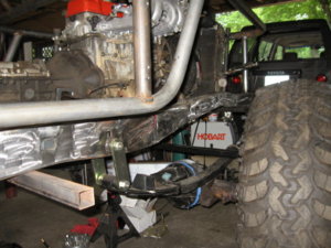

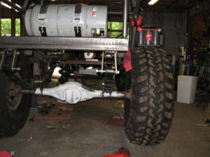

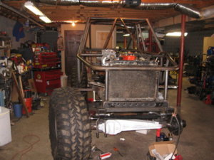

Thought I'd share a little
So, uh, what did it USED to be?
No no, that's what it is NOW. What did it used to be?
It started as a donor frame, 89 runner 4wd auto.
chassis: SN 508 DOM
ft axle: 85 front axle, shaved, strapped, braced, fj80 hp, 30 30 kit, d-flanges, v6 calipers, fj40 rotors, welded diff, 4.10 gear, TG hysteer, 1.5 spacers, ram assist, home tapped 89 steering box
rr axle: 89 rear, shaved, strapped, welded 4 cyc third (electric locker sittin on the bench for it), all factory brackets gone spring pads moved in
springs: 3 inch buggy springs ft/rr with bottom leaf removed from each pack
shocks: bilestin 5025 14 inch strokes
engine: 85 22re converted to propane, one wire DUI distrubter, one wire converted altentor, moved back 6.75 inches from factory, red top optima
tranny: L52 with HD clutch kit
crawler: TG HD 23 spline output crawler plate with A/A 5.0 trail tamer gears
tcase: Chromy 23 spline input shaft, with longfield chromy rear output shaft, still gotta get twin stick for it
Dshafts: equal length ft/rr, both run yota joint/flanges made with .250 wall DOM tubing
H1 wheels: recentered yota pattern, 8 bolt 16.5 x 9.5, with inner locks from Dean Reed off pirate4x4.com
tires: 42x14x16.5 IROCKS, and yes I still have full swing of the steering and I still need to screw the stops in before I hit the springs.
I may have forgot some stuff but if you have any questions feel free to ask.

Pics of which part? Gonna build the rear case up today and install it for the last time. This week will be rear case crossmember, ft seats install and batt install and run the lines.

Alright will get some pics up this weekend. Got the batt mounted, the pedals, DUI distrubiter is in ready to go and started on the firewall. I'm gonna get the driver seat in tomorrow so I can set the pedal spacing for me driving. Try to get the propane loc and regulator mounted tomorrow to. This week hopefully I'll get the steering and brake lines ran.
