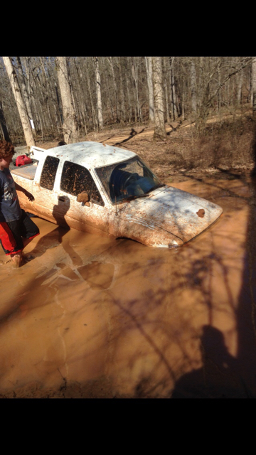

Just hydrolocked my motor out at durhamtown GA about two weeks ago, and I am looking for ways to avoid that. Obviously a snorkle is the right solution but I hate, with a passion, the way they look. So what are some alternatives? I was thinking about running the intake into the glove box, then dynamatting the sh*t out of it so it wasn't supper noisey, but would the intake get enough flow if I did that? And would the dynamat help with the noise? I've heard it's actually pretty loud. Second option is running the intake under the truck into the bed, then into my tool box. Do you guys think that the airflow would be restricted this way? Even if I ran like 3 inch tube?

Sorry guys it's a 92 Toyota with the v6 3.0 and staying out of the mud isn't an option hahah. I didn't mean to drown the mofo and I won't be going tht deep again but I do enjoy the average mud hole what not. You guys think running a 3 inch tube from the intake to the back of the truck into the bed would reduce my air flow?
