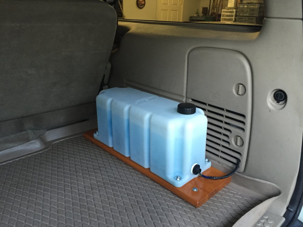

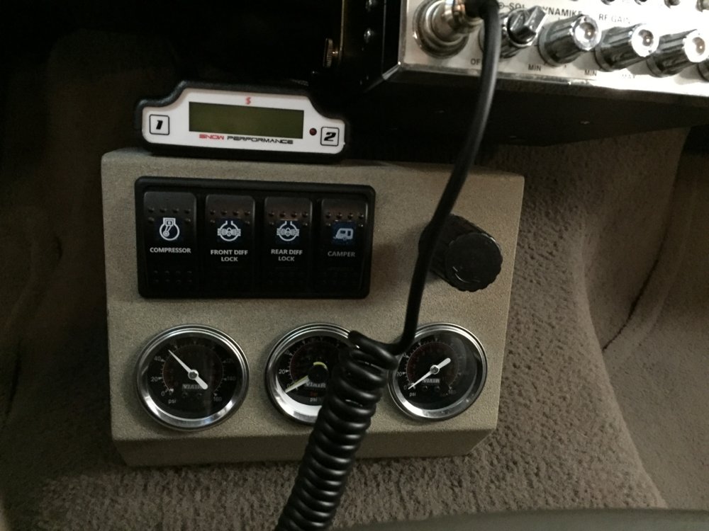

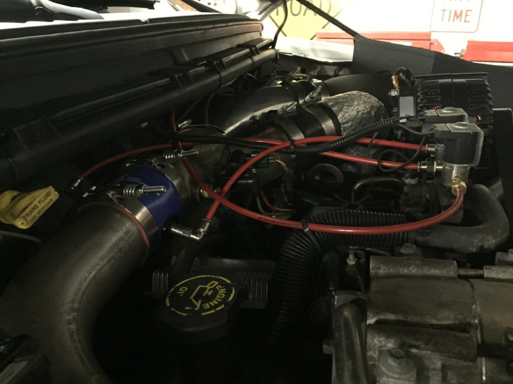

I have recently upgraded the ol' Excursion with new injectors, Adrenaline HPOP, upgraded turbo, and also added new boots and hoses to everything. These additions made a big difference in performance, but also increased my EGTs. I tow the camper a good bit, and this made me nervous so I did some research and decided on a solution.
Last weekend I installed a Snow Performance Stage 3 Methanol Injection System. I haven't used it for towing yet, but from what I can tell this thing is going to be great. Using a 50/50 water-methanol mixture they claim that it adds 70HP, and my butt-o-meter agrees.
At WOT my exhaust temp hasn't exceeded 1150 degrees F while using the system, where if you stay in it with the system turned off it will approach 1350. Also, my boost pressure has jumped from about 25PSI to 28PSI.
I don't know how it affects fuel economy yet, but they say that it will be better.
I will give more feedback after I do a little bit of towing with it.

My system is a fully modulating kit for economy, and then when the second stage kicks in it is very noticeable. You can fine tune it on how you want it to modulate and when to bring in the second stage.
50/50

@Brando welder How much water/meth you use will depend on how hard you're driving it. It's all dependent on boost pressure to activate the nozzles in the intake piping. More boost, more water/meth. That one may even read EGTs and adjust accordingly since it's the fancy, electronic setup. The one I was going to use was just two pressure switches set at two different boost levels since the Cummins in my truck is archaic and entirely mechanical :D

Just to clarify this system reads boost pressure and exhaust temperature to control the amount it injects.
For egt control water is just fine. We saw very small differences between boost juice (snow's brand at the time), washer fluid and a 50/50 mix.
