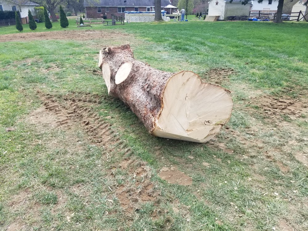

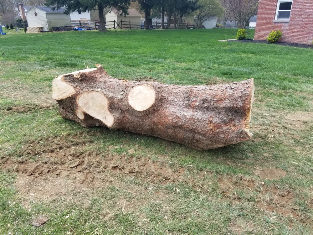

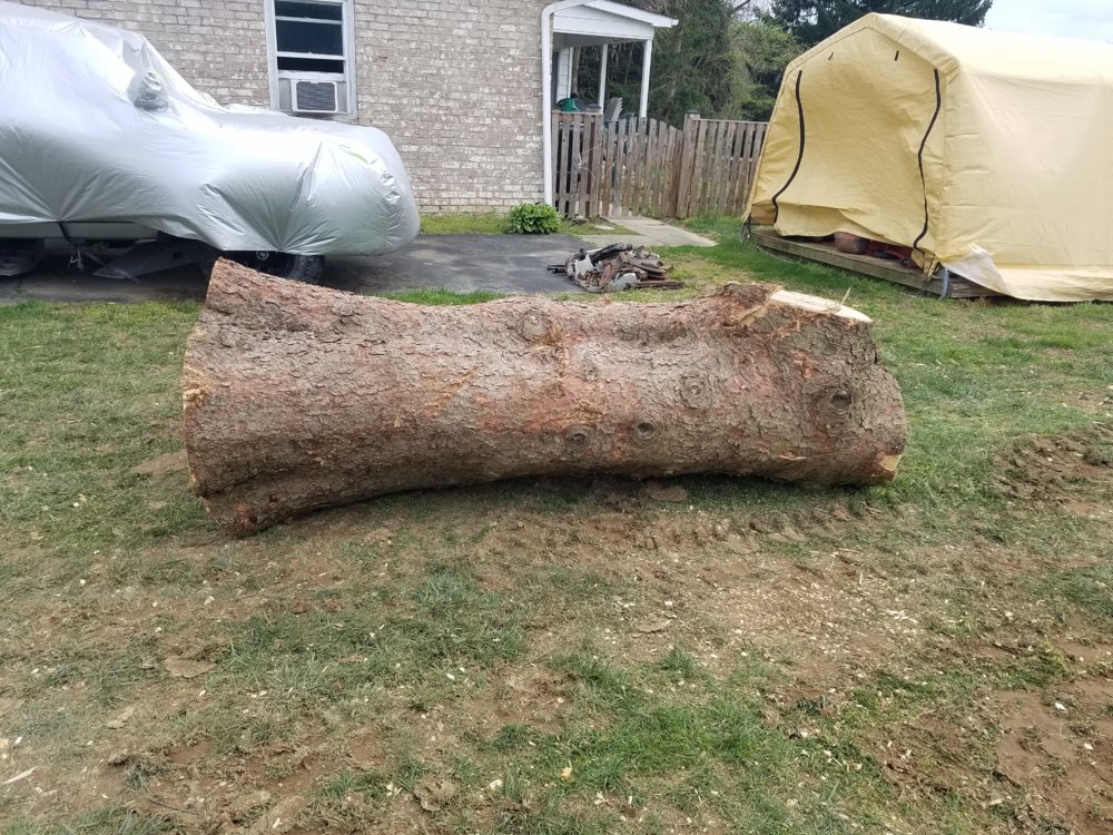

Had ecru, and take out a bunch of overgrown pines and spruce from the yard.
it didn't it didn't occur to me until they were nearly done that maybe I should save some of it to make something. Luckily they had this huge chunk of the largest Spruce they had set aside because it wouldn't fit in their chipper. So I had them hang on to it, and have made arrangements for a guy with a portable Mill to come out to the house tomorrow.
it's about it's about 32 in at the base, 8 feet long and maybe 24 in at the top end. Realistically, how much wood can I expect to get out of this? It turns out I was already planning to make a farmhouse extending table for the dining room anyway. Thinking I could use this for the table top.
would it be would it be better to shoot for slats like 1 or 2x6s , or to get wider planks?
I have no concept of what the realistic yield is on this kind of thing.
I mostly just thought that it would be really cool to have something inside the house that came from outside. I felt bad enough about taking out the trees that have been here way longer than me.

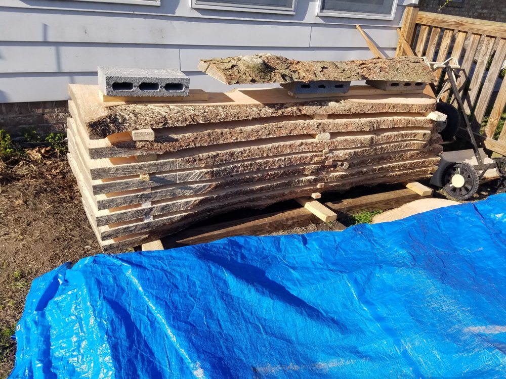

Stack it on some cinder blocks. Sticker it between layers and lay some tin roofing on top. Add some weight to the top of the stack if you can, or even band it up to reduce cupping. I’d go 2.5 inches for a table top, that way once it’s dried and milled you’ll have 1.75-2 inch top. I’d also just have him plane saw it with live edges on both sides. You can always pop a chalk line and cut into widths once it’s done shrinking and cupping.

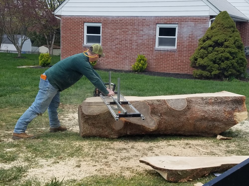

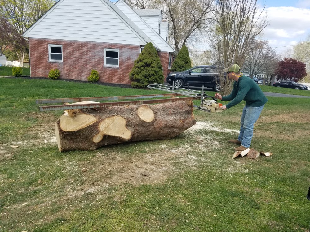

Well, got it cut ubto 2" slabs. 7 of em, probably 4-5 will be good for planks.
Guy see mb ed to think theyd be ready for a kiln in 60-90 days, which is tolerable.

Well in classic fashion, once stacked and under a tarp I completely forgot about this project :lol:
I guess it's about time to find a kiln?
Unfortunately I just noticed at some point the cheap tarp frayed and is open on the top of one end. That probably happened in the last month.
