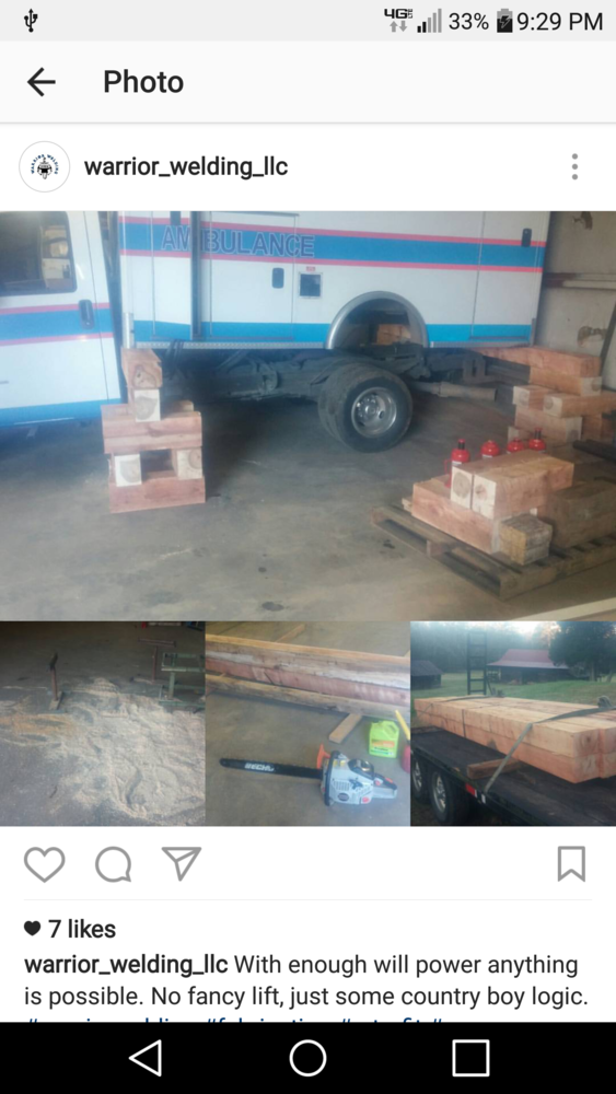

Does this count....remounted on a new chasis the same way.
Get a few Smart cars, jack the truck up, drive under and Kazaam, tall jack stands! Excursion didn't crush them in the commercial and I can't think of anything else they would be good for, except maybe a doorstop...
^^ heavy and expensive but it works!
All hickory 15 footers. Got 3 full length pieces left. Most all the blocks too.
Was way cheaper than a lift I couldn't afford in a building I don't own......
But it was a friggin work out for sure. Got my son to help on lowering it down. Took twice as long since we mounted it against a custom cab extension and it had to be sealed against the cab and the body.

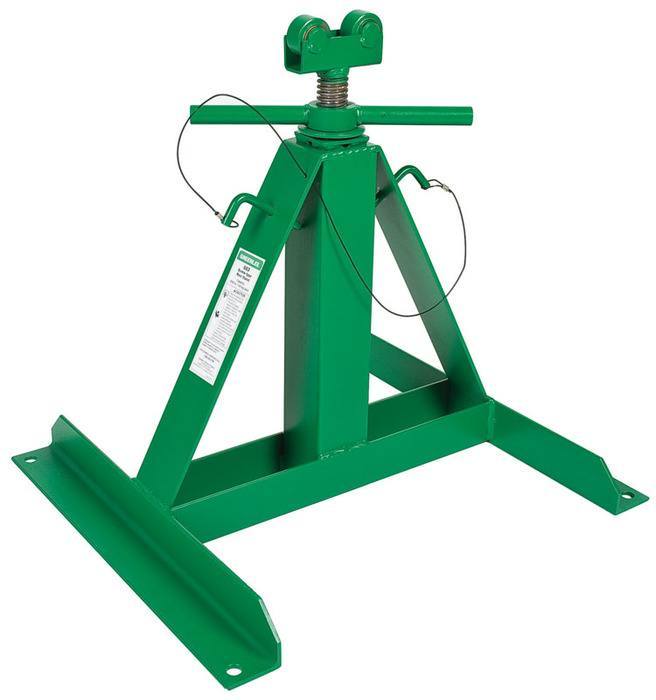

I have 2 of these with a piece of angle welded on top of the rollers. Work great and infanitly variable position so you get your stuff perfectly level or raise it a little with the stand.
