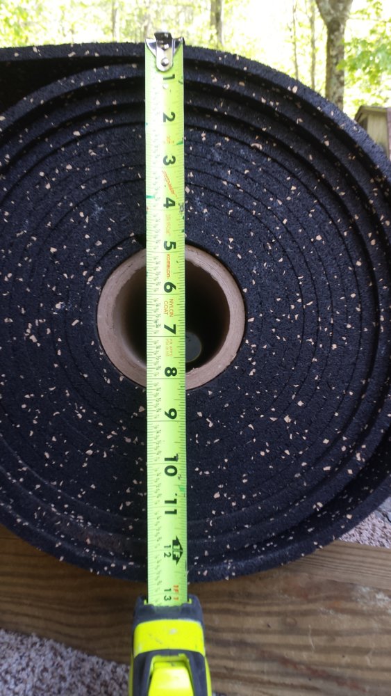

Ok...I don't wanna unroll this. Its heavy and I'll never get it to roll back up properly.
So..who can run the math and figure out the linear footage of this roll of rubber flooring.
3/8 thick
13" total outside edge to outside edge
Cardboard cone is 3 3/4 "
Don' forget to show your work! I need to learn this equation.

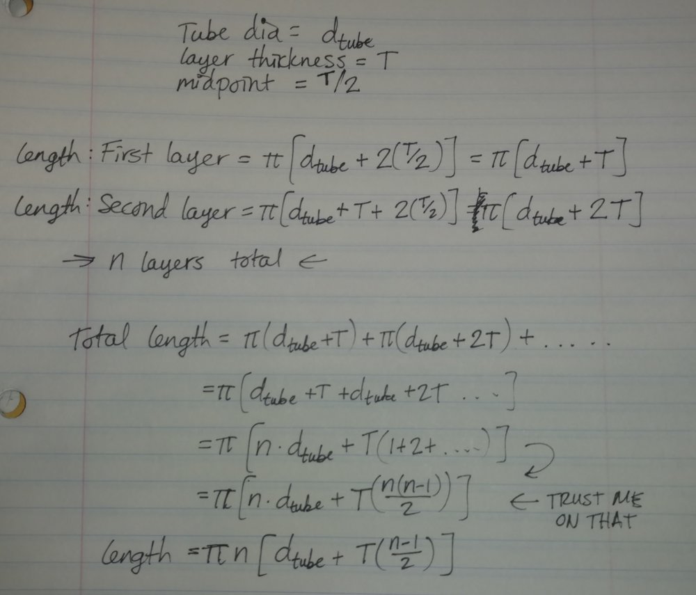

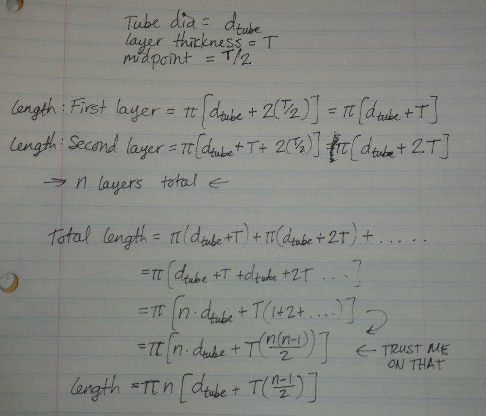

You're doing the calculation, but I've derived the formula. Because the material is thick, I used the midpoint of each material layer for the diameter of the layer, for slightly better accuracy in bending. Still ignores the fact that it's a spiral and not just a bunch of concentric layers.
Count the number of layers for n, and do math.
Mic drop. I'm leaving to go night fishing, bitches.

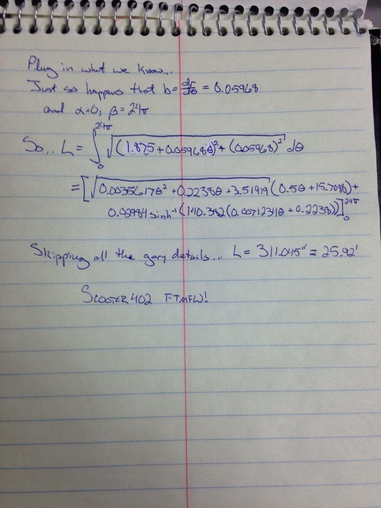

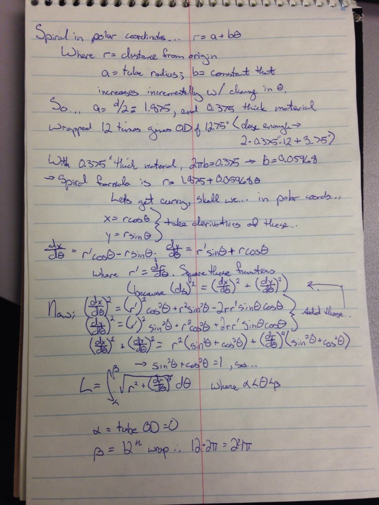

I know there's already been a couple of correct responses to this...one of them cheating, but it's still a win. Let's see how a scientist would approach the problem...
This can obviously be approximated very closely to a spiral. After all, past the first couple wraps, it is a spiral. Attached is a derivation of a formula for arc length, since you specified to show work...
The first formula is a general formula for a spiral, where you begin with a constant (tube diameter) with a factor that increases the radius incrementally with a change in angle rotating about the origin -
r=a+b(theta).
The integral above for arc length comes from the integral for the length of a line.
