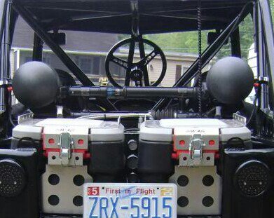

Most guys i seen used two big screw clamps and mounted them to the rollcage, I left mine in the tow dog also.

Get next size up tubing. Cut off an inch or two, weld some ears on it and drill them out. On mounted side, weld a nut to bolt into.
Two for each drive shaft. I do have issue with slip yokes running out, so I ziptie them to the mount.

OD clamps from Gen right 4x4. Double stacked to mount both my spare shafts. Both happen to be 2 " od.
