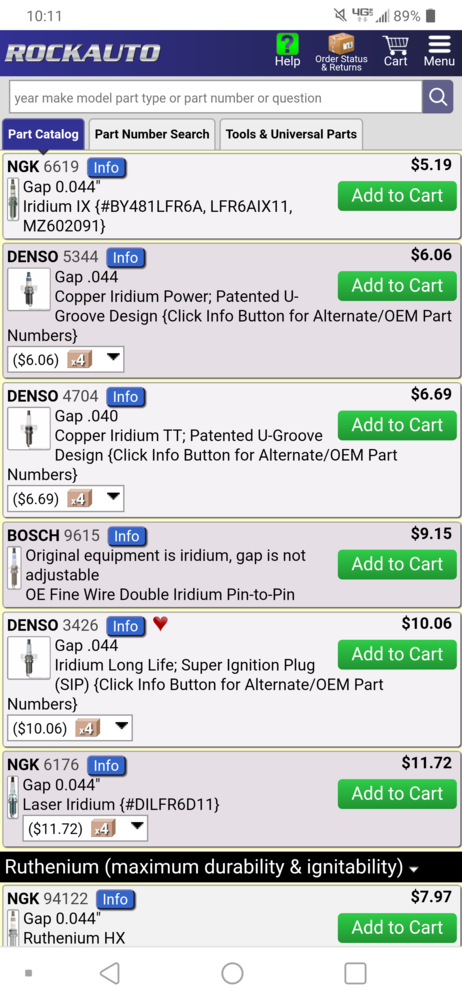

Wifes camry has hit 125k. I figure its time to do the plugs in it. I have no idea what the difference is between all these different options. A little help in choosing what is best or would be a factory replacement would be appreciated. Its a 2012 with the 3.5 by the way.
For exact replacement, you want the #3426. Stay away from Bosch. All others will work, but the cheaper ones may not last as long. Have fun with that rear bank.

Didn't look at your article but I know it won't be fun. That's why I asked instead of just buying any old plug. I want what ever lasted this long so I don't have to do it for another 8 years.
Go with the OEM plug. I always do. Never Bosch or Autolite. Ngk or denso is good. Originals are likely iridium. They're likely $12-14 per plug but hey, you don't have to do it often! I stay with OE spec stuff always, since the mfr researched, chose the plug & based it on design. What's that saying? Buy once, cry once?
