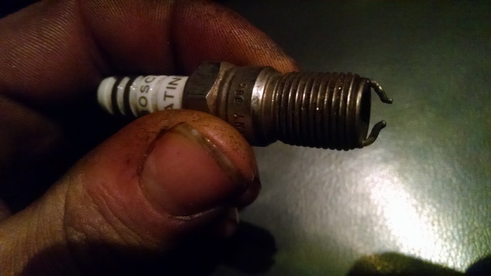

I should post a pic of a Bosch platinum plus 2 I removed from a 4.6 ford. I never install Bosch or autolite.

That's what i thought, but material and manufacturing differences can contribute to resistance to fouling, arcing along the porcelain, etc.
