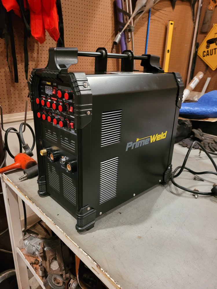

Well, i ended up going with the Prime Weld. Honestly, the only reason i went with it over the AHP was the warranty shipping terms. I'm confident the machine are similar, but wanted the peace of mind. It showed up yesterday.
