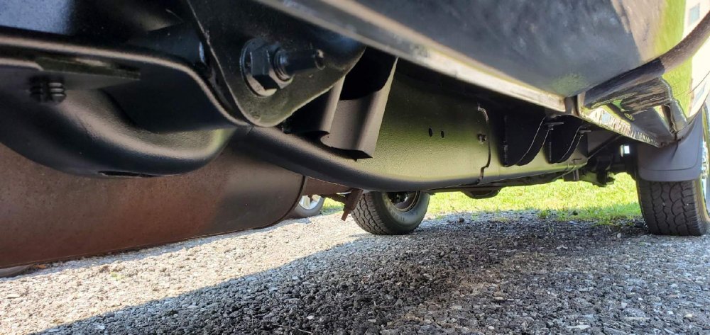

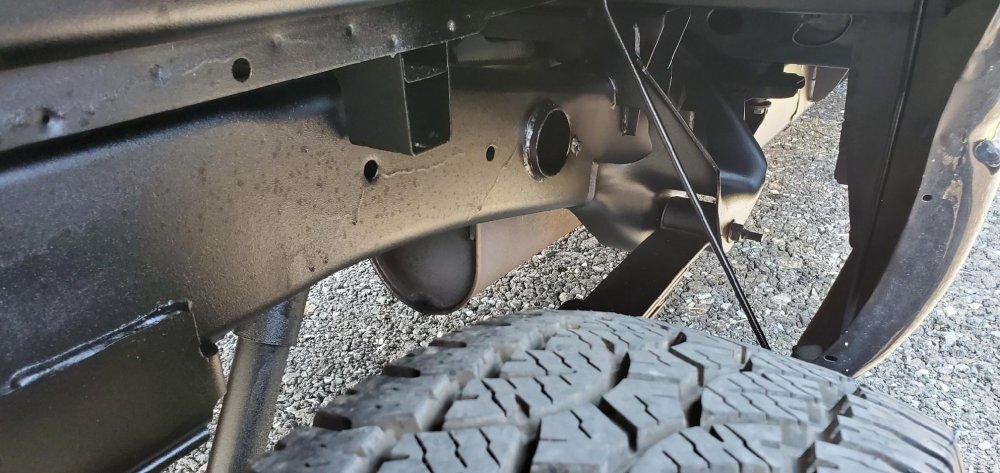

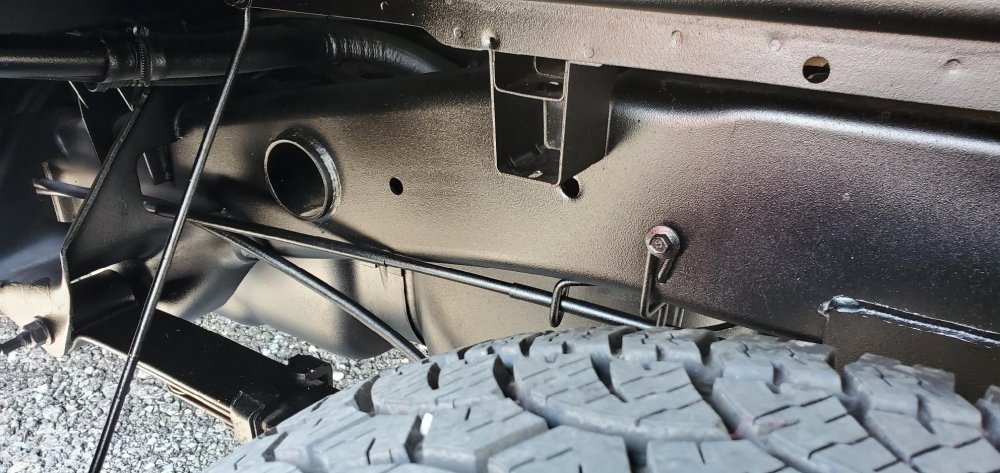

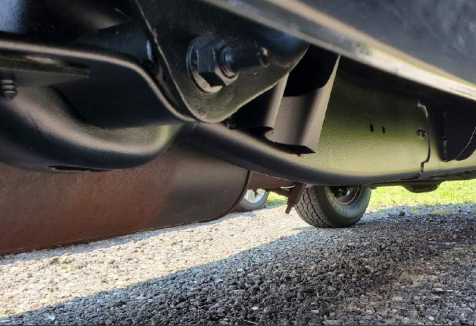

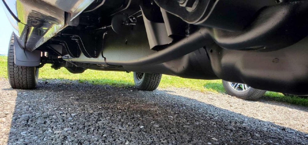

Been shopping for a four door tow rig, found a low mileage truck that I wanted to go look at. The supplied Carfax shows the truck has spent its entire life (13 years) in PA.....I asked for undercarriage pictures, because I do not do rust (been there, done that). The dealer claims it is rust free and was undercoated by the original owner.
It is a 3 hour one way trip, otherwise I would eyeball it myself.
What do you guys think, been burned a lot lately, I think I am looking at lipstick on a pig.....but maybe I am too bitter.

Are those pics current condition or when it was first done? Looks too new for the condition of the muffler & wheel well lip to me...
That is also frame pictures, the main part is where the body attaches to the frame. And that is a recent coverup. I've always been told that unless you take it to have it done before it ever sees rain or salt, you are just covering up rust. My grandfather had a truck he bought brand new with 7 miles on it, took it straight to the coating shop and had the whole thing rustproofed and in 5 years it was rusted still.
Being from PA, I will never buy a car from PA ever again.
Yeah, I noticed the overspray on the muffler and the shocks. It does look clean, but I am a rust snob and I don't like buying flips of any sort........the dealer down the road has a HUGE inclined ramp that they drive used vehicles up so they can stand underneath them and spray bomb the underside......

I grew up in Pa. and remember before salt. The price consumers pay for wet roads in the winter is incredible. It quickly destroys the metal our cars are built from. It causes extensive damage to steel bridges and migrates into concrete rusting the rebar in highways. I was saddened to see it used here. I recently went on the hunt for a newer Suburban. I looked at a few with rust and one had been sort of painted underneath to cover the rust. One part that never gets painted but is a pretty good indicator of salt exposure is the driveshaft. I know a lot of them are aluminum so then look further at the fuel line fittings. The lines are coat but the fittings seem to rust quickly.
Run ..... all that purdy paint is hiding sumptin'.
