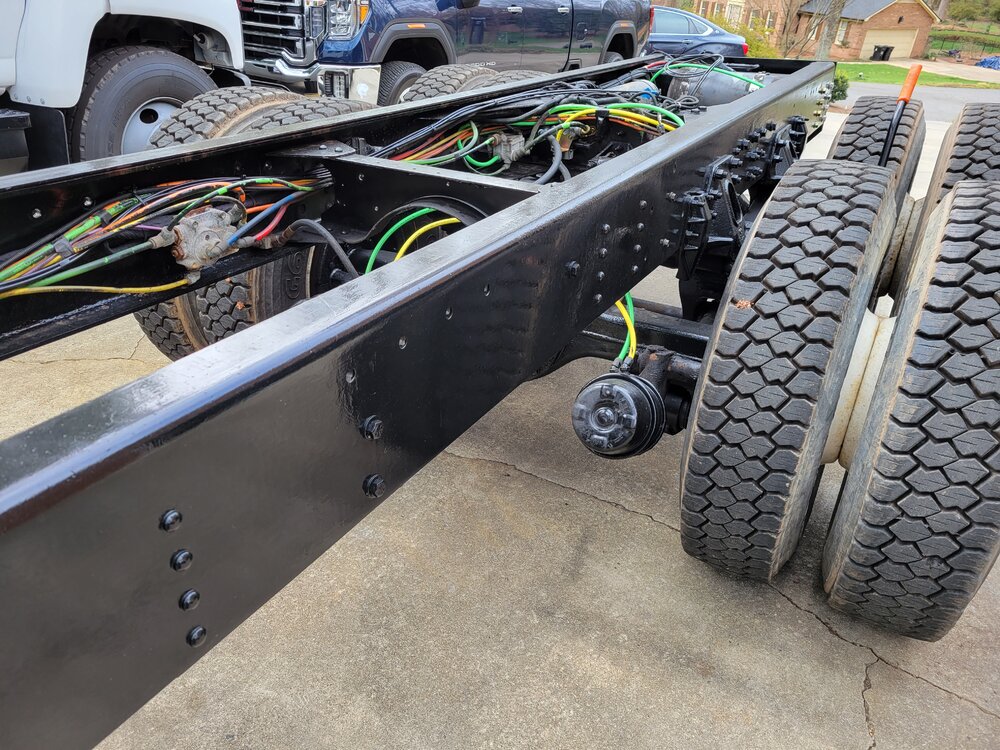

Big fan of the bucket and brush method, can't hardly tell a difference.
