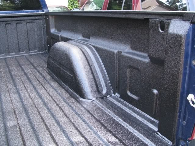

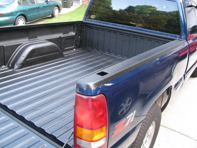

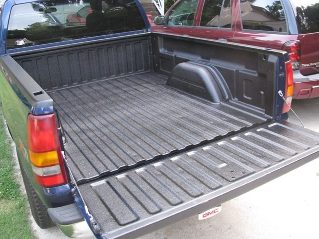

I had gallon of Al's that got damaged by FedEx, so I decided to spray it in the truck over the weekend. I had an existing professionally installed liner of a different brand than I carry in the truck when I bought it. It was faded terribly and pulling up in a few spots. After I ground/cut/sanded/filled the spots, I took the gallon of Al's and sprayed a thin topcoat over the bed and rails to see how far I could squeeze a gallon. I'm going to spray some Scorpion over it eventually, but I didn't want to waste my stock of Scorpion in case the existing liner started lifting under the Al's.
Came out pretty good. You can see the ripples a little in the middle of the bed where the existing liner was sprayed unevenly. Once I lay down a thicker coat I should be able to smooth it a little.
Yes, I did all of this with a gallon! ;D
