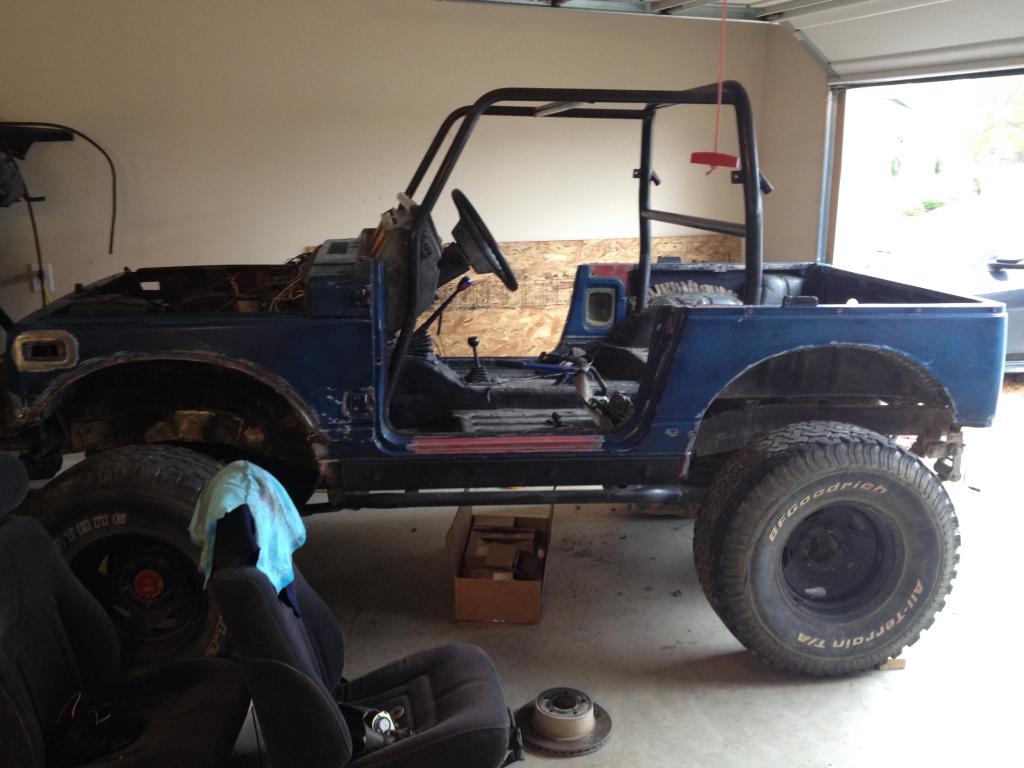

87 ZUK with God knows how many miles and a blown 1.6 8v tracker engine
yj spring and SOA conversion front and rear sitting on 33s
stock trussed axles, welded rear, hub front
basic cage, front stinger bumper, tube sliders
misc odds and ends
this thing is pretty beat, rode hard and put away wet...
i dont know why i didnt think about posting a build thread a while back when i started it but i got a lot to go so please enjoy. I figure this is the best way for my buddy to follow the progress. Please feel free to give me ideas and dislikes, with a low budget in mind haha

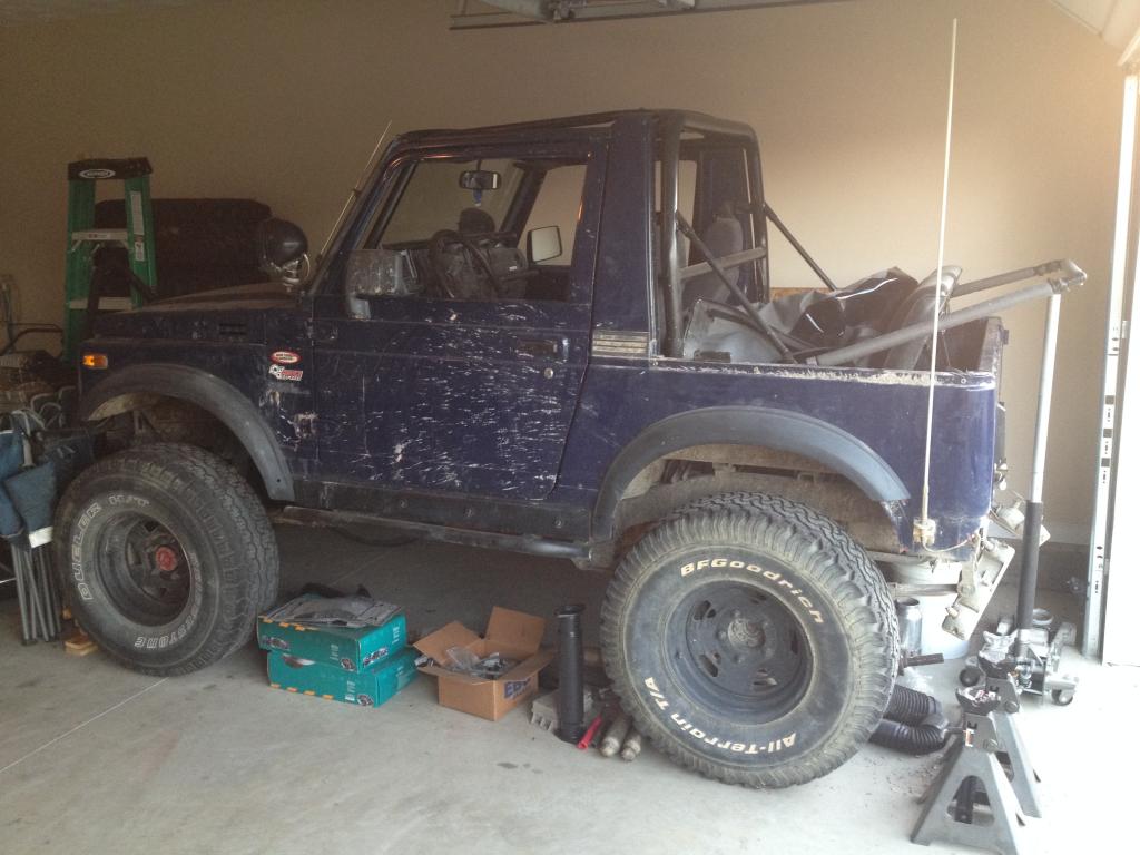

how Squidward started out it's journey

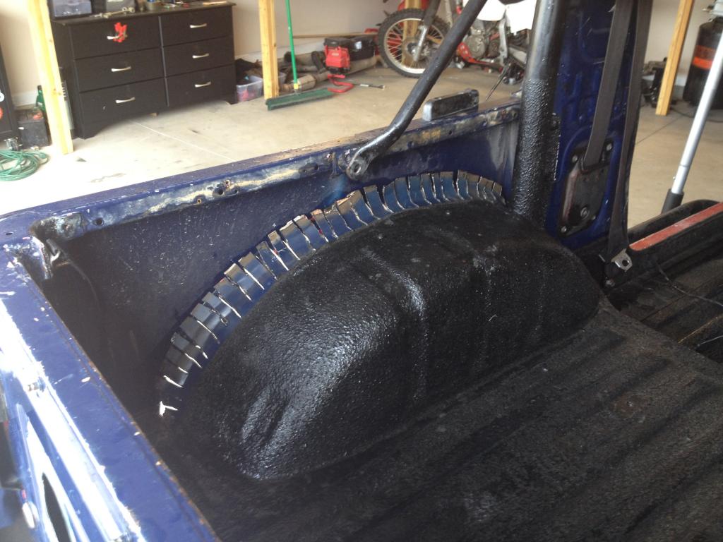

ripped off old fender flares to find that the factory mounts are spot welded on with a combination of rust mud
so i decided to remove them in hopes of finding better fender flares

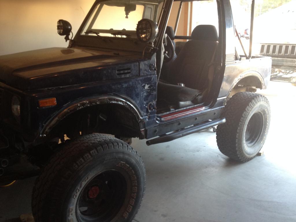

the fenders needed a face lift so i started the process of a "virtual lift"

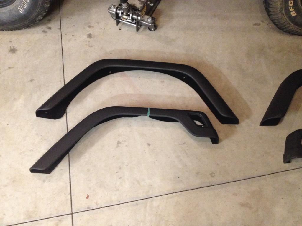

picked up a set of new factory TJ fenders and took a 6" piece out of the middle to make them fit the front wheel well

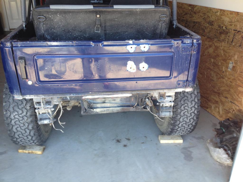

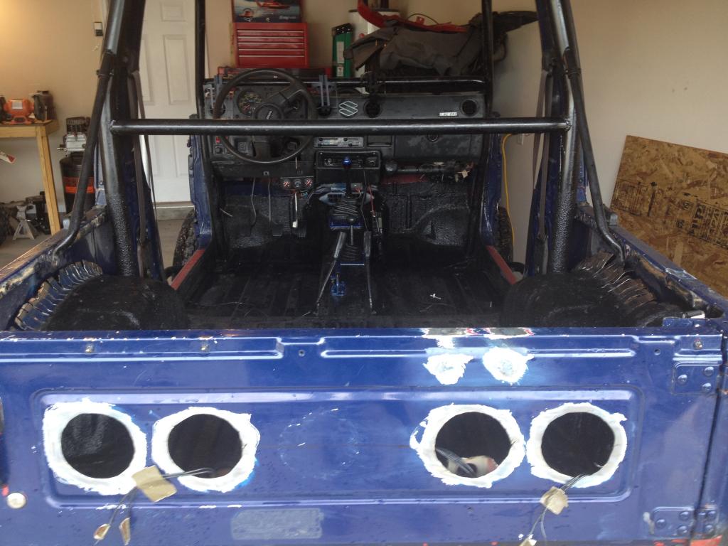

removed the factory rear bumper and brackets, found a spider web of wiring, and welded some plugs in the factory spare mount holes

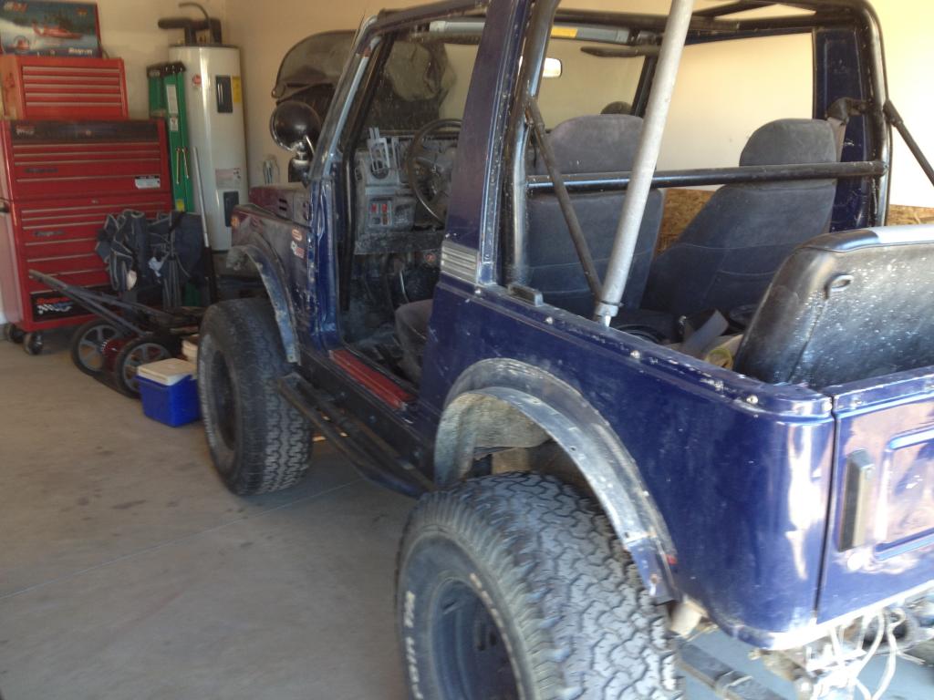

stripped out most of interior for more room to work, decided on building a rear tube bumper eventually so had to find a new place for tail lights

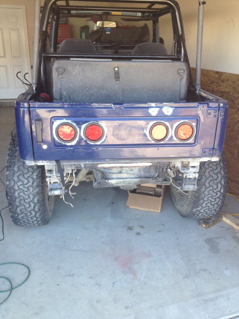

with tail lights being fitted
how Squidward sits at the moment
