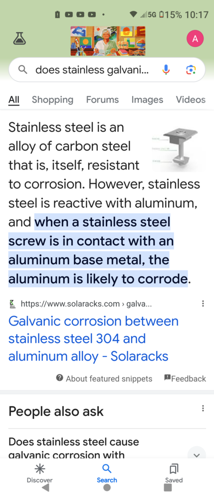

Not being a prick.....but I disagree completely with this statement. Check the grade. I've sheared many fasteners in aluminum and delt with all sorts of messed up threads using stainless steel hardware. In my opinion the pitting and overall corrosion is worse using some stainless alloys in aluminum.
And another's
opinion besides my own..
I would use a very good grade of anti seize if using stainless steel or any other fastener for that matter.
And another'sView attachment 415984 opinion besides my own..
