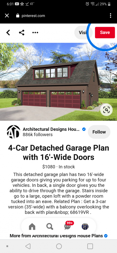

Starting a garage build. Anyone do blueprints?

Have a solid idea of what we want. But a couple builders obviously what something drawn up. Pretty simple build.
A lot of those house plan places will modify the plans for a little more money.
The fine print on those plan house sites is that they don't include framing/structural and very likely can't be used to get a permit. Especially since the OP wants to make significant changes to the version he kinda likes, my suggestion is to not bother purchasing plans that will have to be completely redone. I recommend definitely find someone who can draw and plan out framing to meet requirements for a construction/permit set. This may also require the assistance of a structural engineer for the longer spans and/or a truss manufacturer. Familiarity with local building planning/permitting is a plus but not necessarily required. Familiarity with the NC Residential Building Code is a must.
