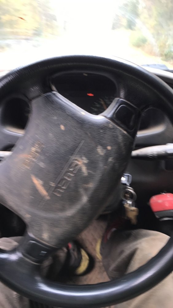

Steering Is at 5:00 while pitman arm is parallel to the frame.

I’m not sure what I’ve broke but as I started taking the steering box off it go me thinking. I thought I had striped the gears inside the box but I’ve never had an kind of clicks or grinds in my steering.
Is it possible I striped the splines that connect the steering wheel to the shaft? It doesn’t look like I’ve twisted the shaft.
Any thought as to exactly what I’ve broke?
Are you sure you dont just have the pitman arm indexed wrong
How many turns lock to lock on each side? Sounds like something is indexed wrong when it was put back together. But your description sounds like it happened during use and you haven't taken it apart?
Bent draglink?
Count turns lock to lock.
Divide by 2.
Turn back that many turns and set wheel to 12:00.
Install pitman arm. Should be parallel to frame rails.
Enjoy.
Or just call me when you have a free minute buddy
I was under the assumption that the pitman arm can only go on specific splines. I haven’t taken it off yet, but if I can just index it back then that’s what I’ll do.
Does everything seem to function correctly still? Hydro assist?
It is unlikely, but over time the servo in the steering box could allow some slippage between the wheel and gear box.
My key wouldnt turn the ignition switch once and I snatched on the steering wheel so hard it stripped. Seems like there was a steel insert in the pot metal wheel itself.
