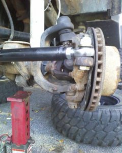

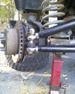

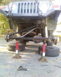

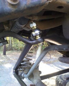

here is the custom with DOM and heims i did

how are Heim Joints for everyday driving, like on the rock krawler kit, are they noisy, require alot of attention, wear out quickly i drive my jeep 40 miles almost everyday round trip to work. that one thin i like about to ORO kit is that it uses factory TRE, can pick them up cheap at any parts store
They use FK rod ends which are way better than anything midwest control, ruff stuff or QA1 offers. Its a rod end with a fabric based PTFE liner which is light years ahead of any injected style race. I can go over specifics of why they are so much better if you'd like.
The rod ends are very low maintenance, they just like to be kept clean as best as you can. They don't pop, make noise or anything like that and since we deal a lot with FK we'll have rod ends ready if you ever have an issue.
