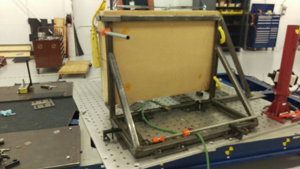

This isn't for a customer, it's in house. We have a 16g test sled for testing aircraft seats in our lab. It has to hold a partition in an event that they are doing next week. It does need to be right though, it will take a pretty hard hit. I have no doubt in my ability to weld it. I will post some pics when I get it going.

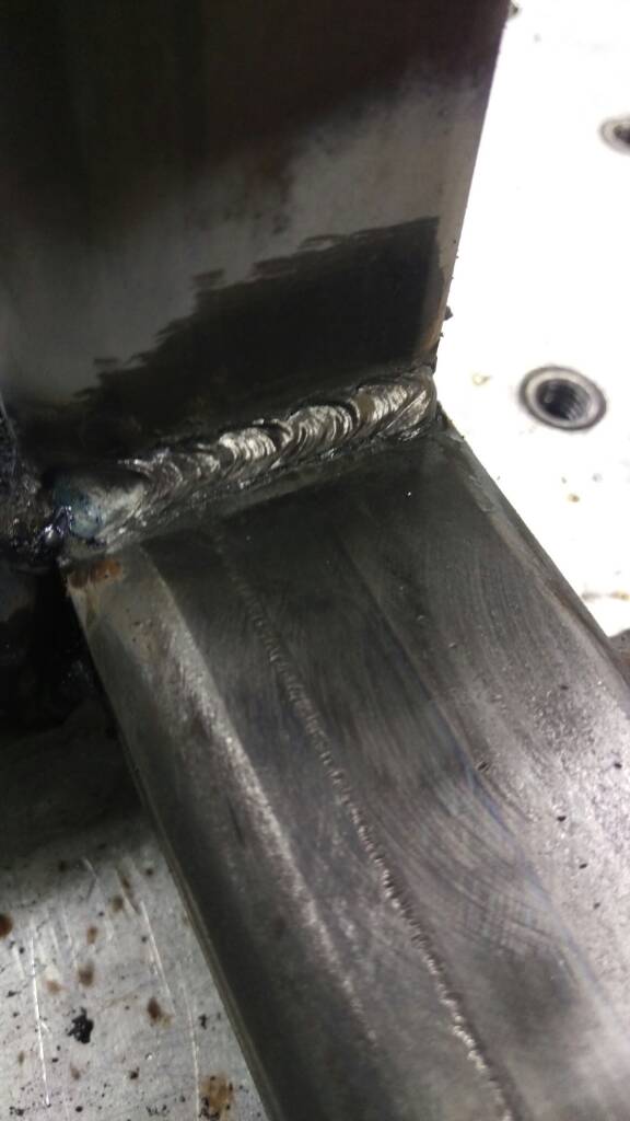

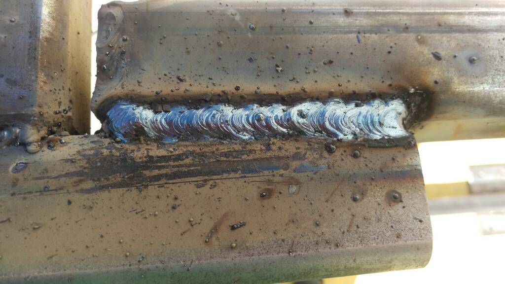

This is what I am putting together. Maybe by the time I'm finished, I will be polished up on my stick welding. Seems I only do it every couple years.
