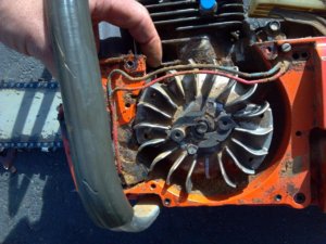

I performed and autopsy to see what caused the problem. I pulled the cover and pull cord assembly off. This is what I found.
One of the air injection/cooling fins (at 6 oclock in the photo) broke and became lodged in the housing where my finger is pointed.
I grabbed a wooden dowel and my favorite BFH and rotated everything counter clockwise and it fell out.
Started right up and ran perfect, like it has for years. I contacted a local dealer and inquired about the part....$225 YIKES! The service tech said not to bother with it unless 3 or 4 were broken or the vibrations we too severe. I cannot tell the difference.
The only lingering question is why the fawk did it break off in the first place? Gravel or something in it, defect, years of abuse, a fluke? Who knows...
Thanks for everyones .02 on the matter. Very glad a new saw is a requirement! More coin for Cruiser parts or at least a new tarp!!!

Went to cut more dead standing locust (:fuck-you:) last weekend. Fired up the saw and dropped a 20" tree. Got about 15ft into bucking into rounds... It was cutting like a dream and then I started to hear popping. I shut it off and could see small pieces of plastic.
Pulled the pull cord cover. The plastic between the cover and saw was all but gone, leaving the wires hanging. The culprit... more disintegrating flywheel. Local shop looked at it. They say that after contacting Husky the flywheel is no longer being made. They told me a few weeks ago that it was like $250 or so: WTF. Anyone have a source on that part? I can post a pic of the carnage and provide a model number if someone has an in.
