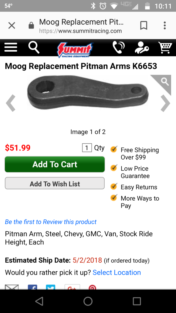

Thanks for the PN reference. Do you happen to know what the length of this arm is? I have read where the flat astro arms are the same length as the CJ's (6.5"-6.75"). The one you suggested looks like it has a slight drop to it, which is fine, but I'm hoping it is 5.5" or shorter.
It looks like there is one locally at a parts store. I guess I can go an measure this afternoon if I don't find anything else.
Yeah, that thread is not the most concise. At first it lead me to believe that a CJ pitman arm would work at 5.5", but that is only for manual steering. The thread then states that the manual steering gear box has a smaller splined shaft.
I'm not sure where you discovered PN K6653 but it looks like it will work well as long as I can get the TRE taper to work. The only thread I could find that referenced that pitman arm is Pretty basic Golden Eagle - Pirate4x4.Com : 4x4 and Off-Road Forum. Apparently it is for a Chevy Express van. Thanks for the help.
