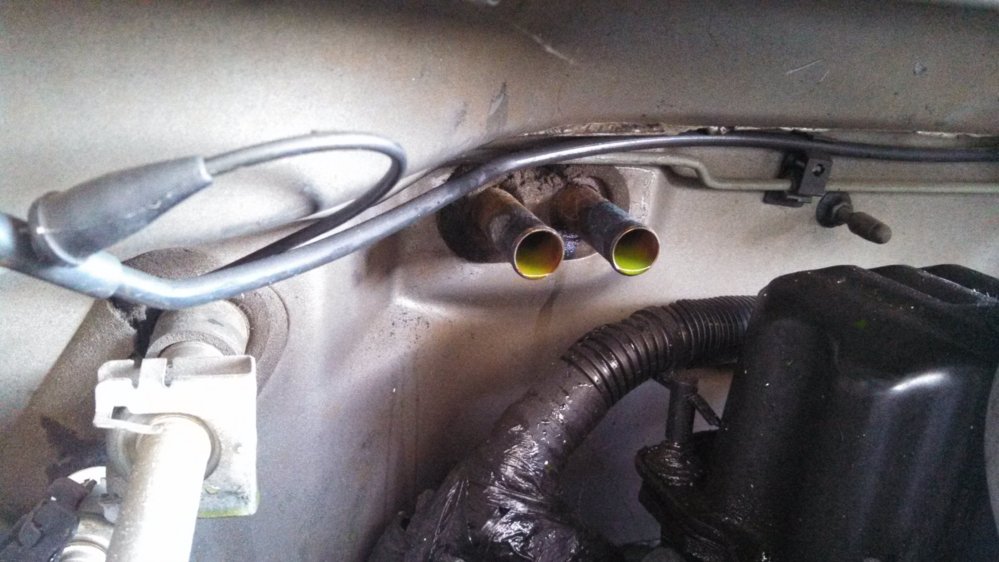

Now we're getting somewhere. There is obviously a restriction in the heater core. Call O'Reilly Auto and order a heater core while taking 3 hours of my day to replace it? Of course not, I have axles to build and my wife isn't a paying customer. I did what I have done so many times over the years. I flushed the heater core with a garden hose. Here's how to do it:
Pinch off both heater hoses just so you limit the amount of coolant that leaks out. Then remove the hoses from the heater core. They may be retained with either hose clamps or spring loaded quick lock fittings like most late model cars use. With both hoses removed I simply connected the hose to the heater core inlet and (Andy Griffith voice on) "Lawd, you shoulda seen what came out of that core. It was the awfullest mess of crud and sediment I have ever seen." I flushed it both directions until only clear water was exiting the core. Once I reconnected the hoses and topped off the radiator it was time to crank it up. The results? Both hoses are the same temperature and the heat output is what it should be.

You'll see a few pics from my 20 minutes out in the parking lot of my shop today. Ask away with any questions.
