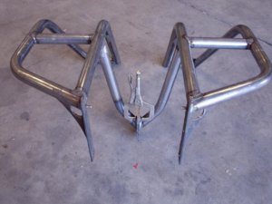

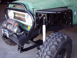

Here is a thought on the front fenders (the area most likely to get smacked)
This is some front fenders from a FJ40 "flat fender" style. I really like them / would be neat to do to eliminate the actual fenders and EXO / do these. I would add the skins myself. Not quite as wide as this example but enough to give some protection from rocks/mud slung off the tire. Essentially same width as current fenders?

Sam,
It sounds like you should buy a Jeep, LOL!
I'd keep the cab, build an exo-cage and just take the doors off in the summer. Maybe make removal sunroof/panel for some more open air feel, and get a sliding back glass if you don't have one.

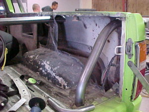

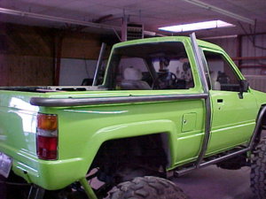

Right now I am thinking I am going to leave everything in place and just do the Exo over the cab / front fenders and then do the side rails down the rear bed like Ken (Bruiser) did on the blue toyota and his XJ.
That way I retain 100% the look and feel of a full bodied rig, but gain the personal protection the cab and keep the body from getting beat all to heck.
I am inclined to leave the BL in place and leave well enough alone but thought I would get a bit more feedback.
Ken - how has the side rail done for you guys / does it seem to protect like you wanted? (I know the green one they did a 2nd tube over the fenderwell that I don't like much)

Side rails on bed / thru bed and tied to frame
