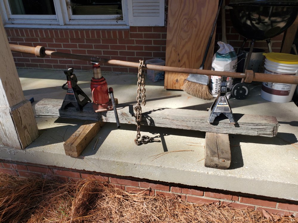

I love collecting and training with old weightlifting equipment. I am especially fond of 1970s york Olympic bars. I normally straighten bars myself but have one that I need help with.

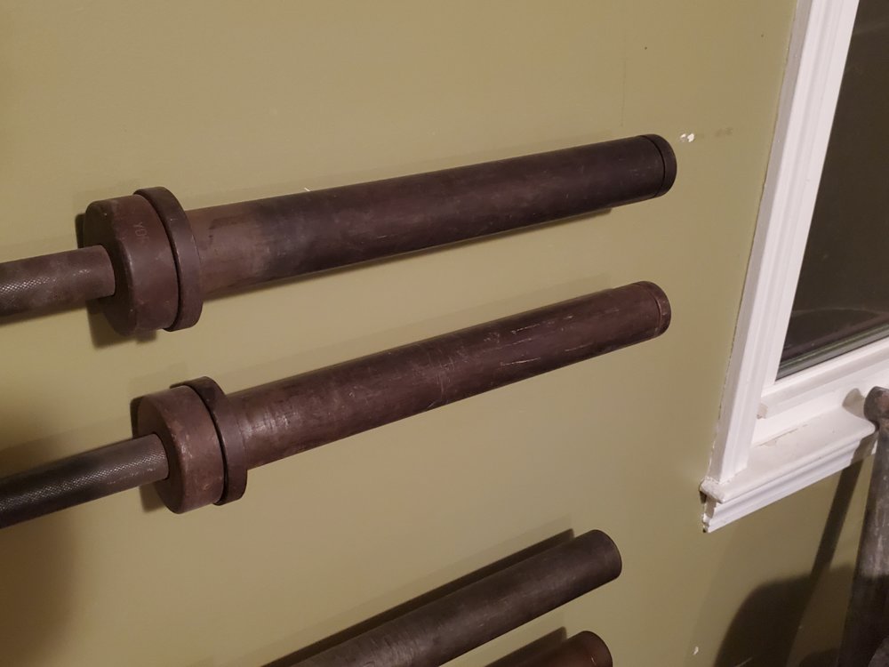

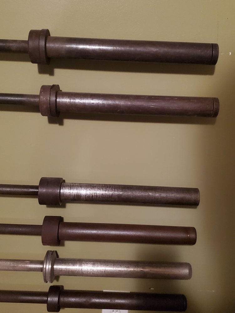

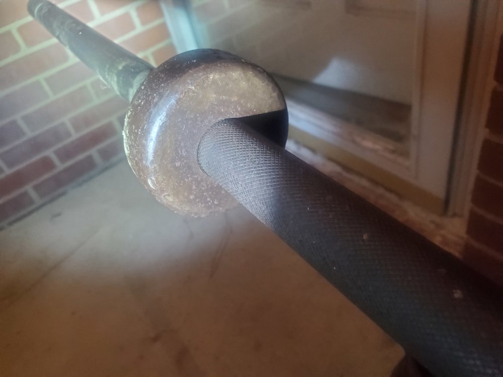

This bar has knurling in excellent shape but is bent on at least 3 axis' and I just can not come up with a good game plan for where to place the chains and jack to start straightening it. I ABSOLUTELY do not want the bar bar bent too far and then have to be bent back the other way. The bar is rated to handle 1000 lbs of weight but loses part of that every time the metal bends. I also do not want to use heat. It is bent about 1/10 " - 2/10" pretty much the whole way down the 7ft bar. The bar can flex a lot before bending which is what makes it so hard for me to straighten at home when bent in more than one spot.
Is there anyone in the greensboro or southern pines area, or within an hour or so who feels confident in straightening this? The collars are not removable in this pic which is part of why it is hard to tell where the bends are
The bar

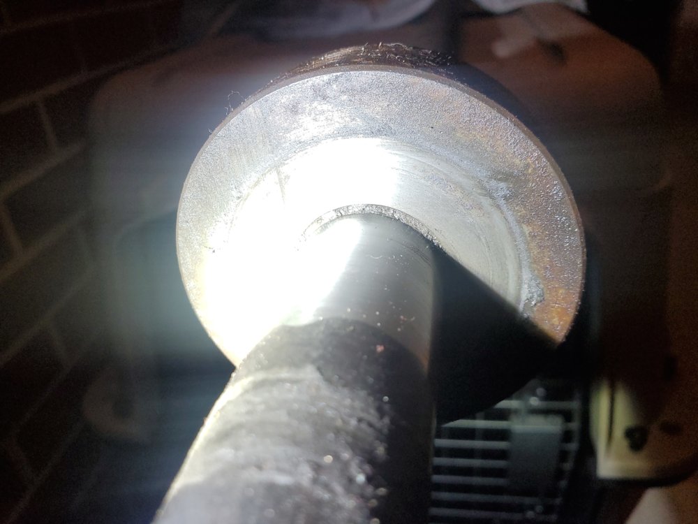

I don't know how the collars are attached. They are not welded but I have never heard of anyone getting them off an successfully reinstalling them without the sleeves and a couple hundred lbs of weight sliding up the bar

I have a beam. And am familiar with barbells. But how much money do you want to spend? To not screw it up is going to take a minute or 30 per bend.

I'm willing to spend $100 plus some beer, but again, I have a beam and a setup for straightening bars but this one is going to be difficult.
I could put it in the lathe and at least mark the run out if you wanted to know exactly which way things need to go. Probably just a $20 and beers. Then you could take it and spend your time bending it back.

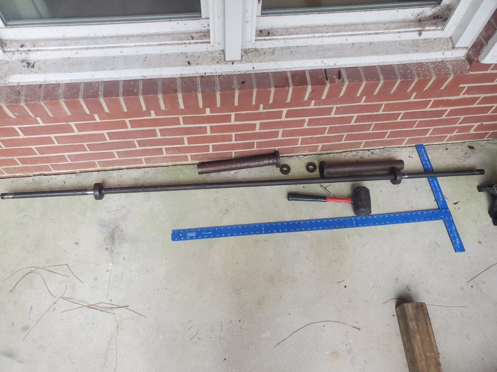

Why not use a set of v blocks and a dial indicator to mark hi spots, bend accordingly with a press, check, repeat as needed? Then you could straighten it yourself and not shell out money to have it done.. (I know, it was kind of discussed above about marking hi/lo spots in a lathe.. there again, your option of sending it off is definitely the easiest.

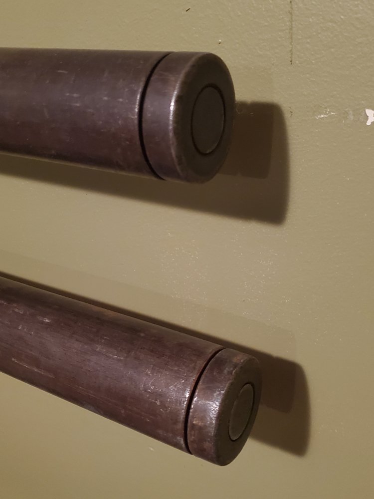

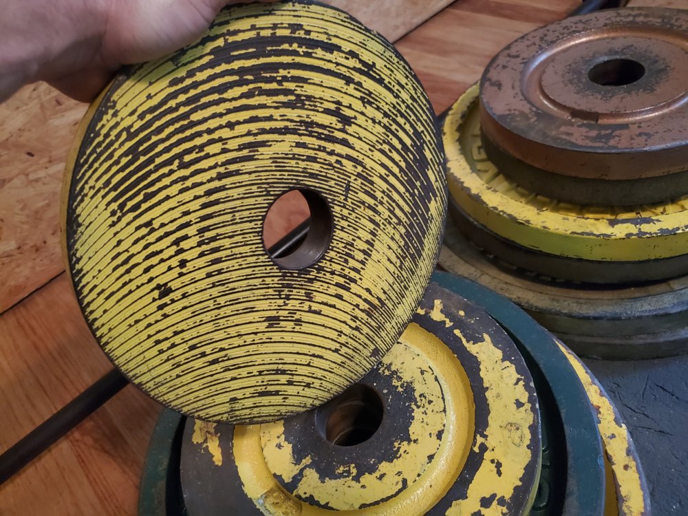

I love old York stuff. York made these bars back when they were milling plates and other companies were casting them. I have a lot of those milled plates too. The bars are iconic and easily identifiable from their split sleeves and donuts on the end. They are very strong compared to even most modern days bars.
This particular bar has about a 1/10" wave all the way down it. The big thing holding me up from starting is that I do not know what part of the bar is most straight so I do not know where to start. My usual setup is easy if the bar has a straight section or just one long bend on one axis.
