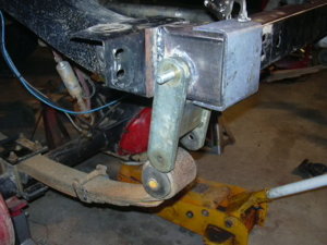

I also welded a 4" extension on the rear of mine, used XJ springs. I relocated my gas back 4" as well by drilling a few hole and everything cleared with the D44. That is until I put the 14B in:rolleyes:
