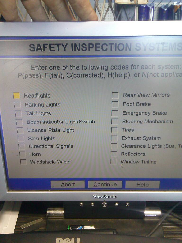

Just saying Ive seen a few dune buggy rigs around the charlotte area riding down the road. They have 0 stock frame rails, or VIN, or title. Just have to register it as a custom vehicle I think?
Winshield wipers and a backup light. A friend had a lowered hotrodded manx buggy that wouldn't pass NC inspection because of those 2 things.
A mini-mag with a magnet worked as a back up light and manual wipers .....

I think the high beam indicator is an oft overlooked necessity. There is also the emissions aspect of it also.
