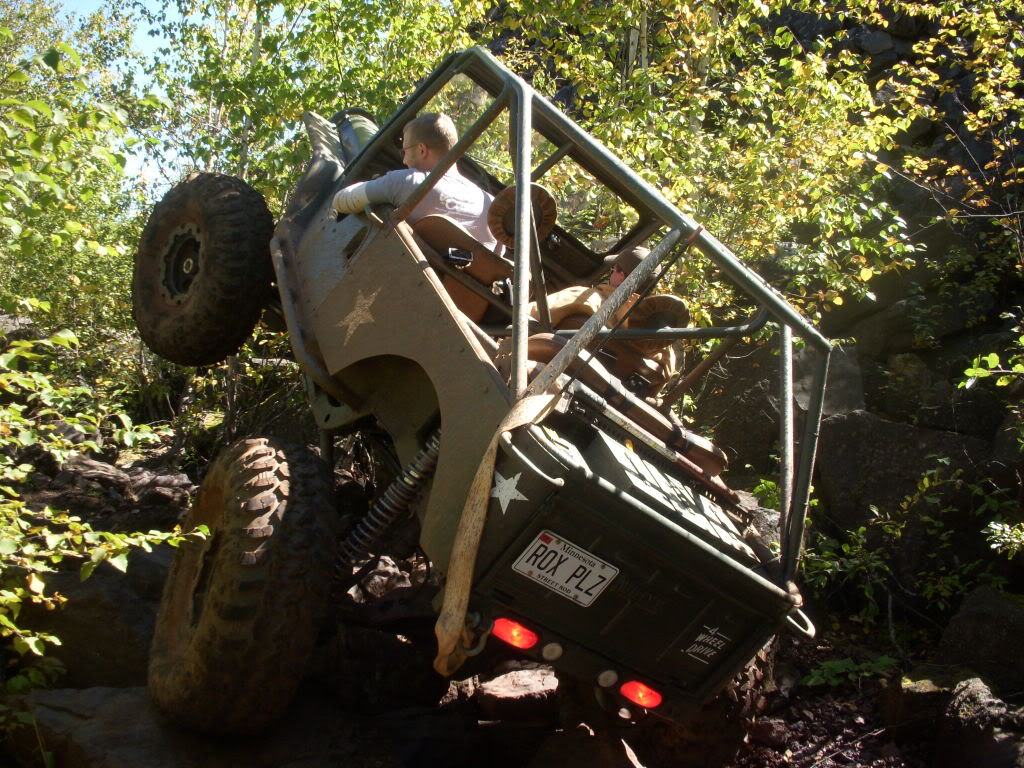

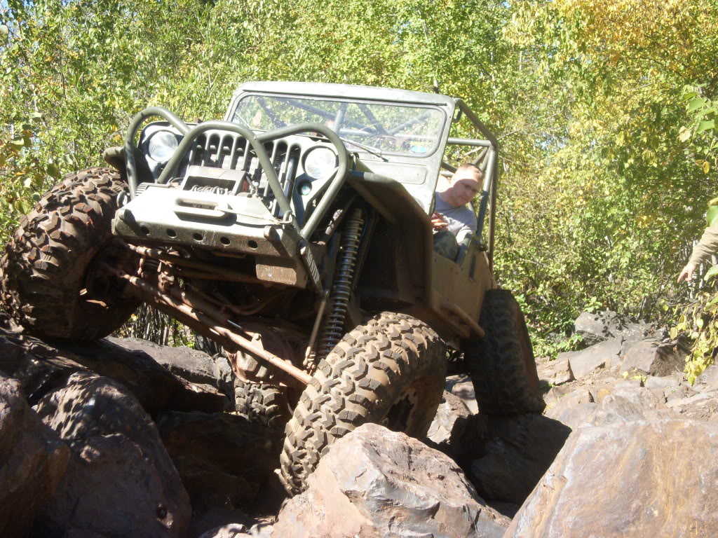

I'm on the cusp of a new buggy build and thinking about how little my rig actually gets used these days.
It would sure be nice to be able to put my family in it and cruise around on nice days. That begs the question, what's legal here in NC? I have MN collector plates on it now that is basically a free pass on the road, but here with inspections, not so much.
I downloaded the inspection sheet, but that doesn't address stuff like engine, open wheel, etc. If I throw some EB skins on the front of a buggy, attach a vin to the firewall with a 2006, 6.0 in it, am I good to go or will I get laughed out of the inspection place?
I rolled like this for a while with my tail light and tag screwed to a 1x6 that was zip tied to the remants of the body.
I went to get an inspection with the bigger caged version and the Jiffy Lube guys said they couldn't. One of their many reasons was the fuel cell. I went down the road to a smaller station and got an inspection.
I have yet to be pulled over and even wave at local cops. I'm sure a Trooper would have a large time with it though.

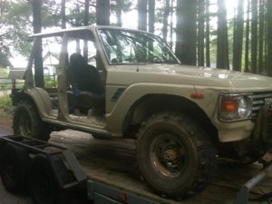

I will be following the answers to this post, because I don't really know where you can bend the rules. I do know that you don't have to have a windshield but you do have to have working wipers...
