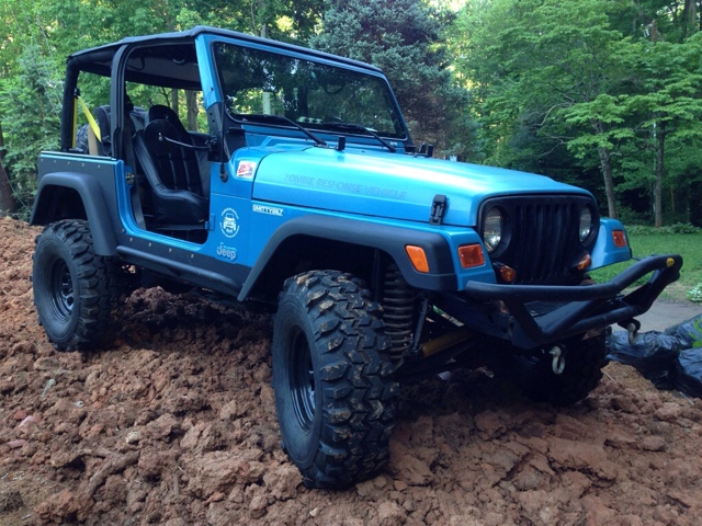

yep. when i had my 79 bronco doors of i just took an extra mirror i had and screwed it into the dash side.
Clay,pick you up a set of cheap relocation brackets and just put the drivers side on and permanetly mount that mirror on.Leave the pass. door mirror on the door .I've been like this since 2001 and no problems.Reason not to telocate the pass. mirror is you can't see it with the door back on.
Most of the "relocation brackets" I have seen either get hit by the door, or put the mirror where you can't see it when the doors are on. Somebody recommended the Harley long stem mirrors to me. I finally remembered to order a pair earlier this week. Assuming they show by Friday, I'll let you know what I think of them this weekend.
I shortened up my door strap with a little sewing and fixed the hittin problem.Kind of a no-brainer to me.
Just for the record, the Harley long stem mirrors are perfect. I bought the rectangular ones. They vibrate a little, but nothing terrible. And you've got good visibility to both mirrors from the driver's seat.

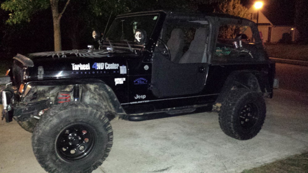

I just passed inspection yesterday (5-16-14) in Huntersville NC with no doors or mirrors on my 04 unlimited and have done so for the last 8 years. I put the half doors on for looks, not that they do anything.
I ended up going with a set of mirrors I found on-line, they sit perfectly still at 60mph and are easily removable for when I am on the trail. They mount to the two torx bolts right above top door pin hole
