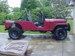

She's a roller...made some spring hangers and got the rear springs and axle bolted in. It's at about 104"wb...
:D
cool...lookin like a cj6
Thanks! Next I need to make the side panels to fill in the wheelwell opening. I've got some beefy 1/8" sheet steel to make them! Should be pretty stout! :D

Better outside pics...
Oh yeah for you cj guys it's got a tach and a clock! :D

Looks awesome man! I like the Superman floormat in the back, maybe instead of smelly CJ, it should be Super CJ, what do you think?
Started making some side panels out of some 1/8" sheet.
Made a template out of paper.
traced it onto the metal...Gotta love DHgriffen got this and a lot more metal for $10
Then cut it out with a cut off wheel and a sawzawl. Just traced the lines with the cut off wheel on my grinder and then went back in to finish the cut with the sawzawl.
The plate will go all the way to the door opening and then cover the big gap in the fender from the stretch. I am going to bolt the plates on through the roll bar bolts on the side and a few other bolts on the edges.

Some progress on the new side panels. Bolted them into the roll bar bolts and added some more bolts down the front too.
