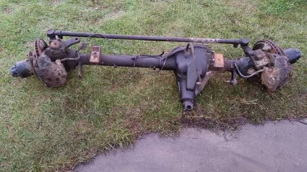

I found a front axle off a 98 dodge 2500 cummins its a dana 60(not sure if its a 1 ton or 3/4 if someone could clarify for me and the width) for cheap, the only thing is its a CAD axle, there aren't locking hubs, so Im not quite sure what that means but all I need to know if it'll work on my Toyota sas project or do I NEED locking hubs
A Dana 60 is a Dana 60....doesn't matter what it came out of in consideration to 3/4 or 1 ton rating. The CAD axles aren't all that much fun to deal with. The aggravating part is engaging the slide collar to lock in the passenger side axle. They also have 4 link brackets all over them. It'd be a pain to put it under your truck. Not impossible, but you'd have a lot of work in front of you.
That's also a driver's drop axle. So there's another reason it won't work for you.
Sure it will, if that's what you want to use. It's almost the same as a GM Dana 60. The only thing I don't like about those axles is the external lockout hubs. If you bust a hub, good luck finding a replacement.
