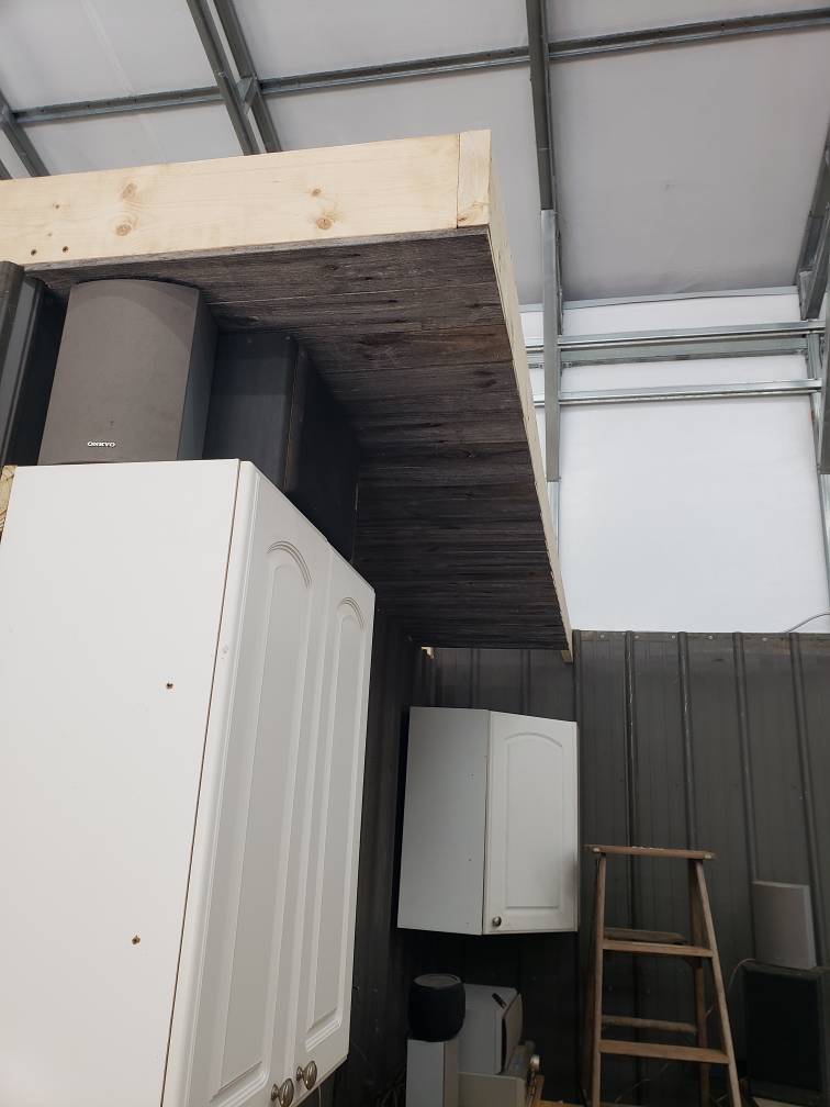

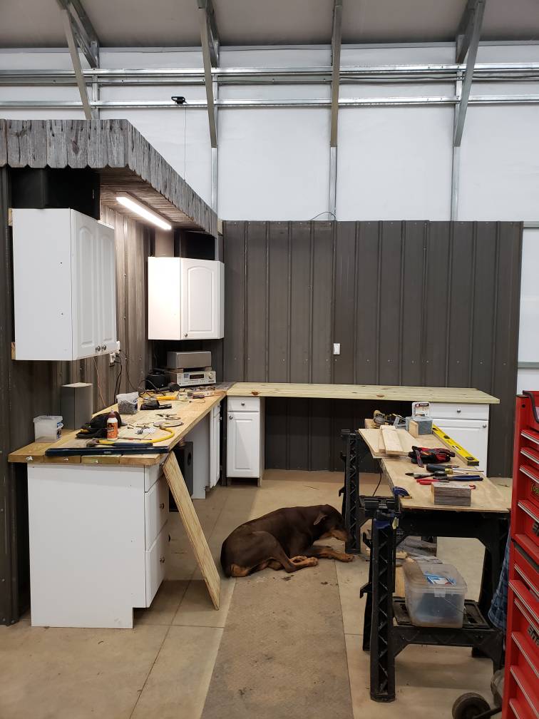

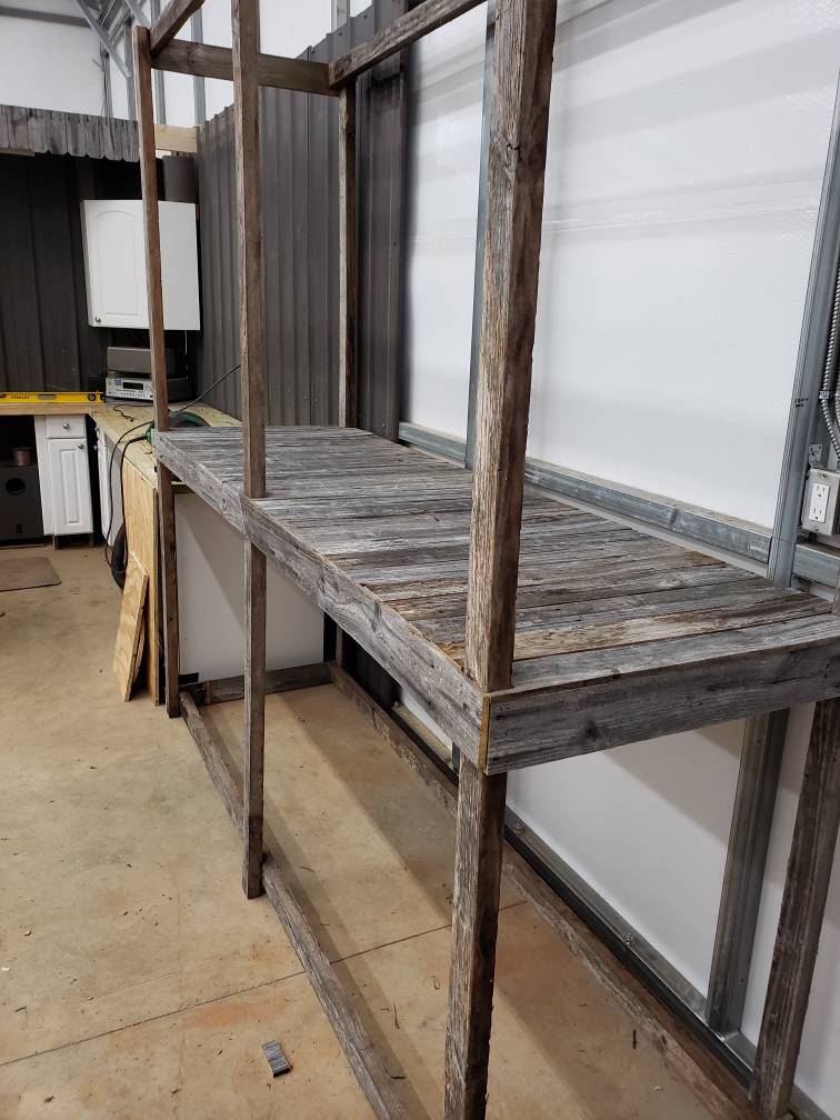

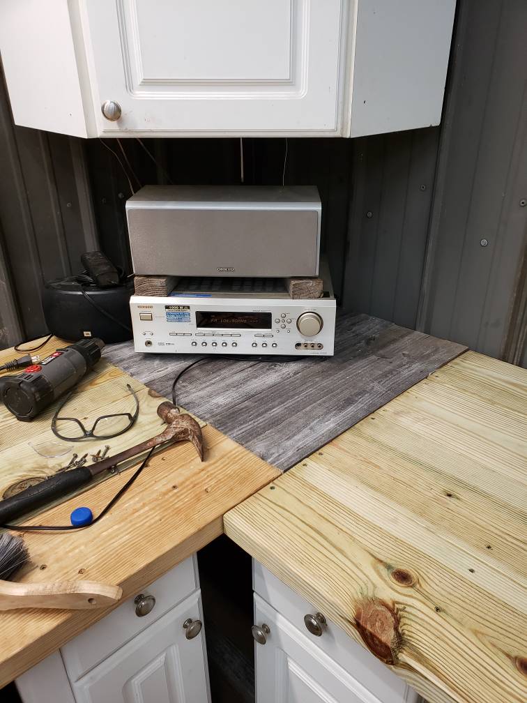

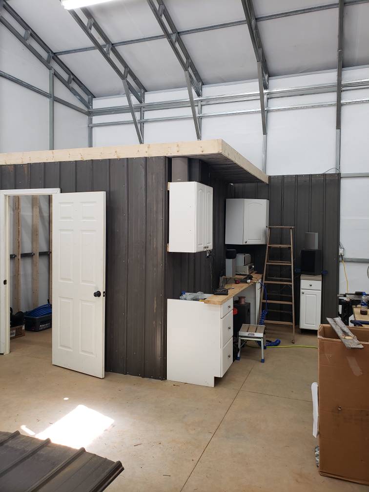

Cabinets up and work bench started, also got my bench light up at wired yesterday.
Looks good
All you need now is a frig and a big screen TV, then you can camp out there & never go inside the house.
Haha working on it, got to pull two more runs, one for the fridge, and one for the hot water heater and the electrical will almost be done. Well done at the panel. Each receptacle has a dedicated run so I'm branching a few here and there.

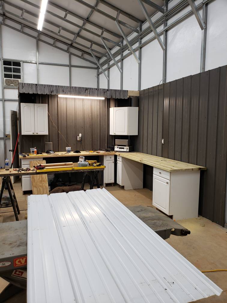

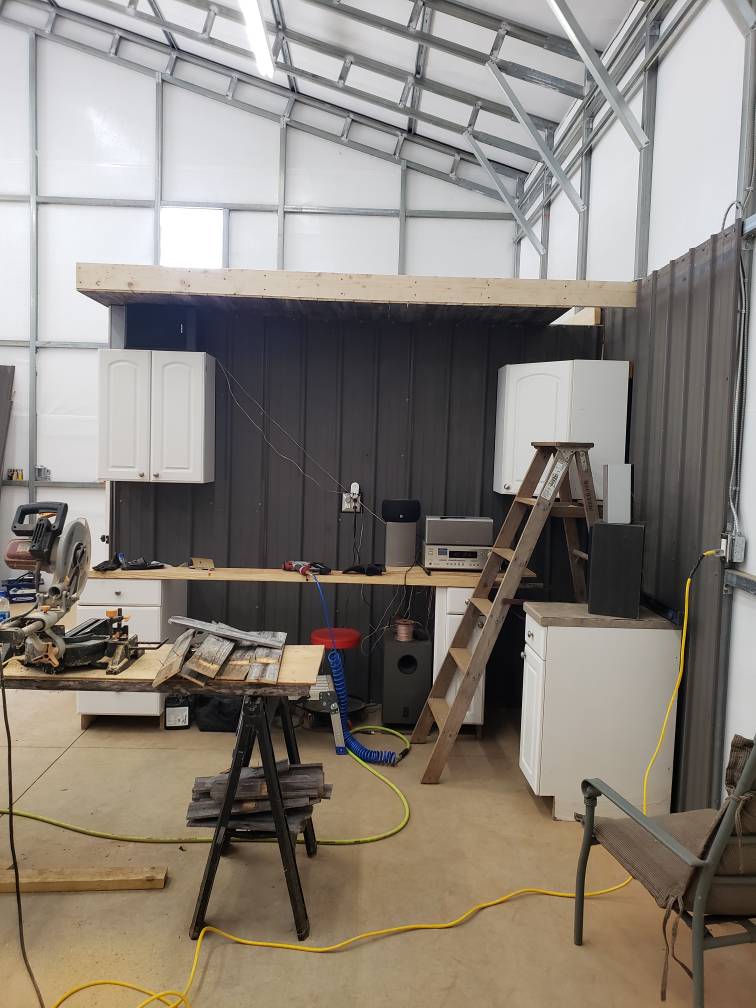

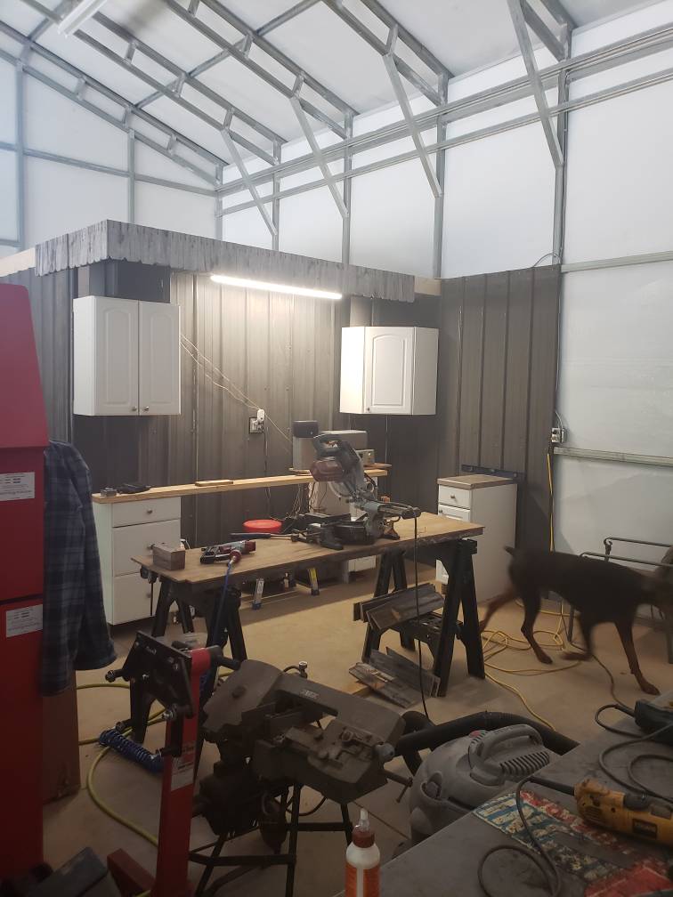

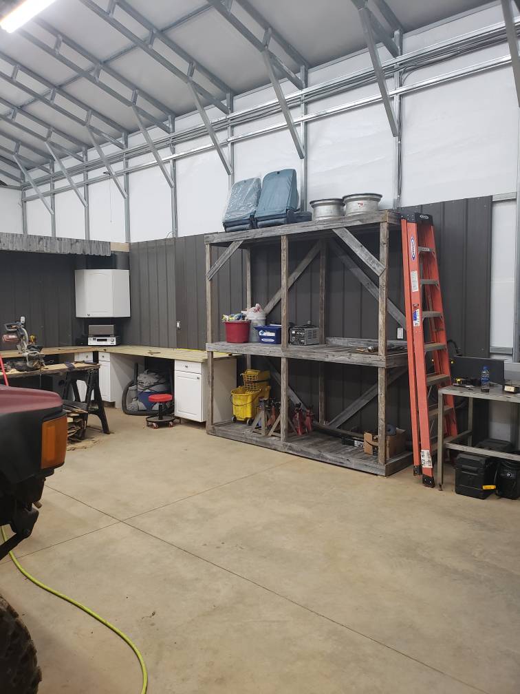

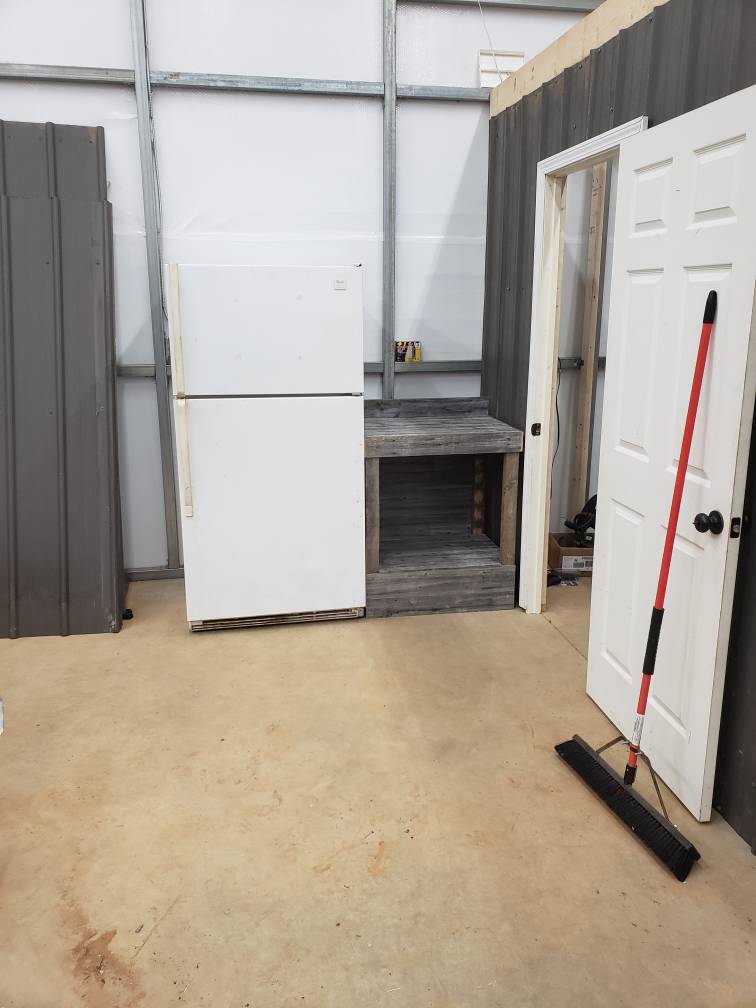

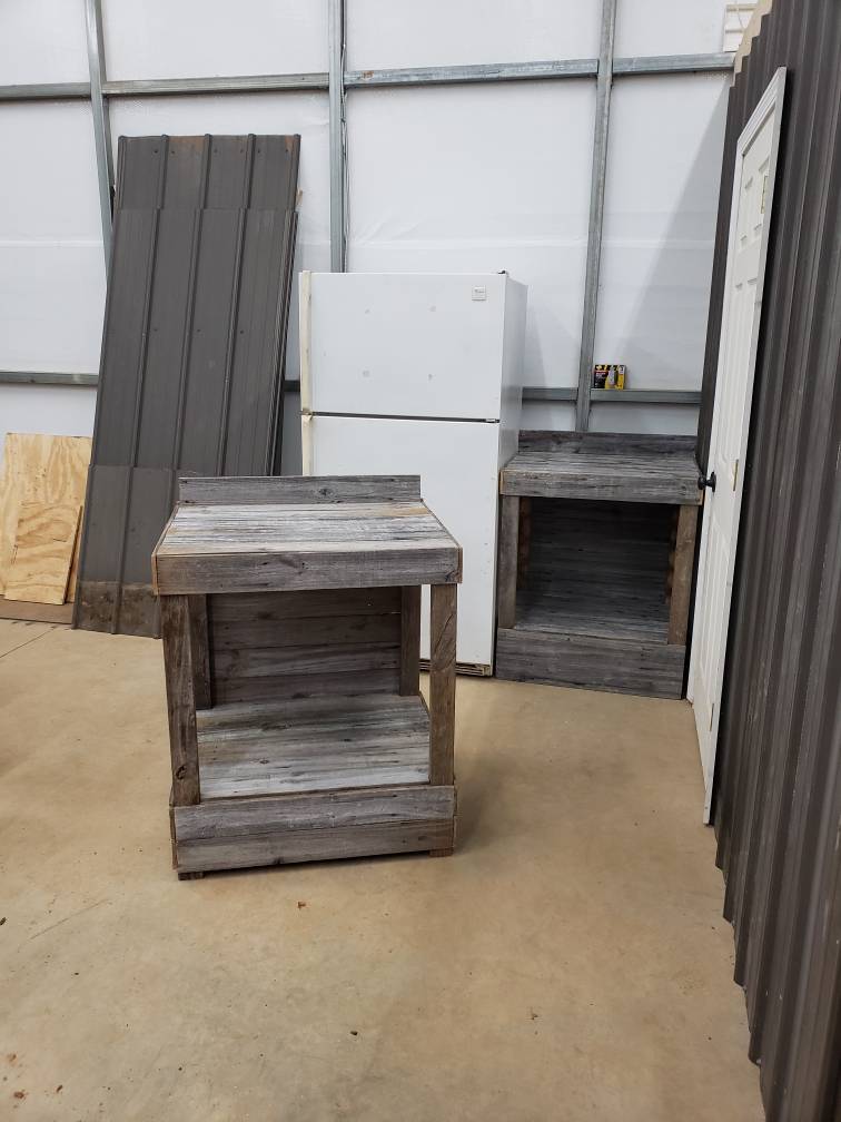

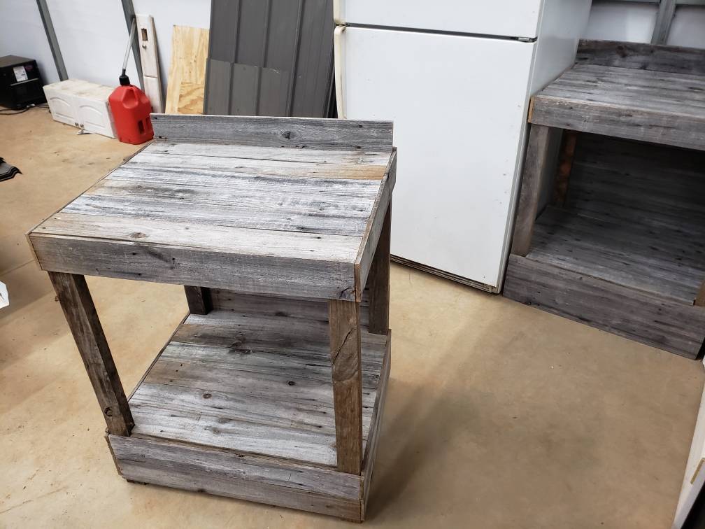

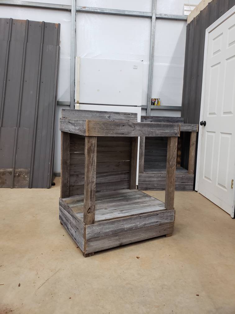

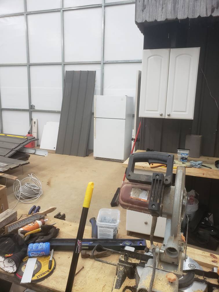

Got busy this weekend since I had a buddy helping. I got two more runs of wire pulled, one for my fridge, and one for my hot water heater. Glad to have my wall sheet back up around my panel box. Also knocked out my work bench area on my back wall, and got my beer fridge moved in! I'll be working on getting the rest of the wall metal up this week and getting stuff in order.
Nice work on the electrical.
Are you doing the work yourself?
I had the the majority of it done for me but I should of done it all myself, i had them install my panel, lights, and 7 receptacles. I wired 5 more receptacles, the bathroom, bench light, and the exhaust fan myself. The wiring that was done in the panel looks great but they didnt spend any time on anything else. But I'm a little ocd but it only takes a few more seconds to pull the wire tight before you screw it down. Really thinking about redoing all the clamp work he done.

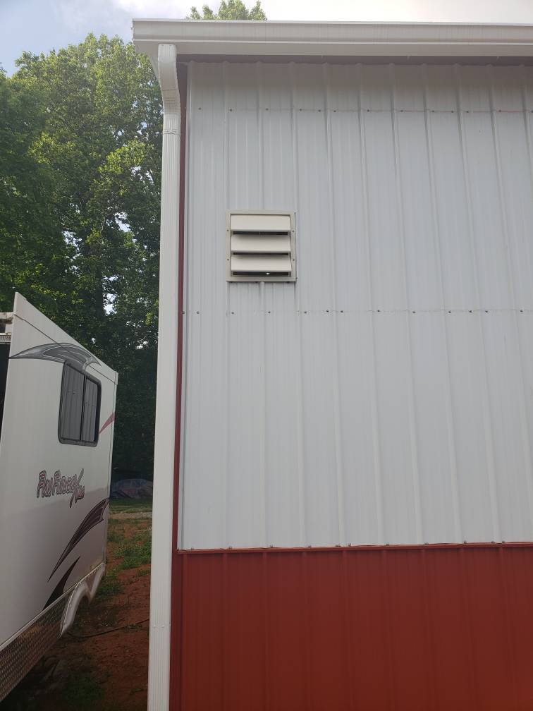

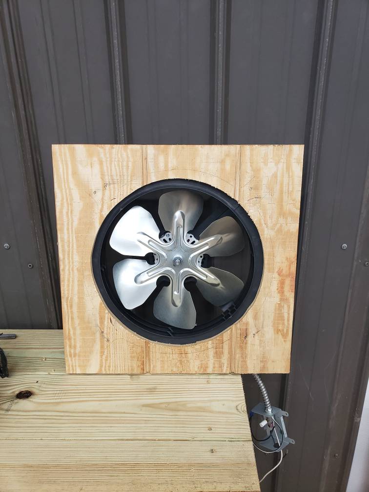

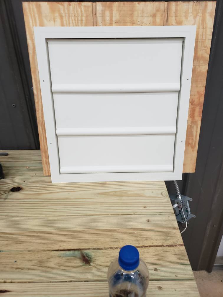

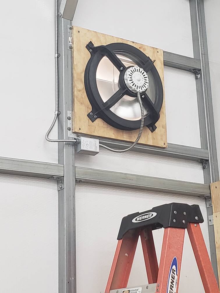

Few pics from today, I cut out the hole which I really hated to do but so far it's been worth it. I did a little trim work around the shutter that I'm not happy with so that will come back off tomorrow. It's just a little tight causing the shutters to hang and not close. But it's up and getting the hot air out!

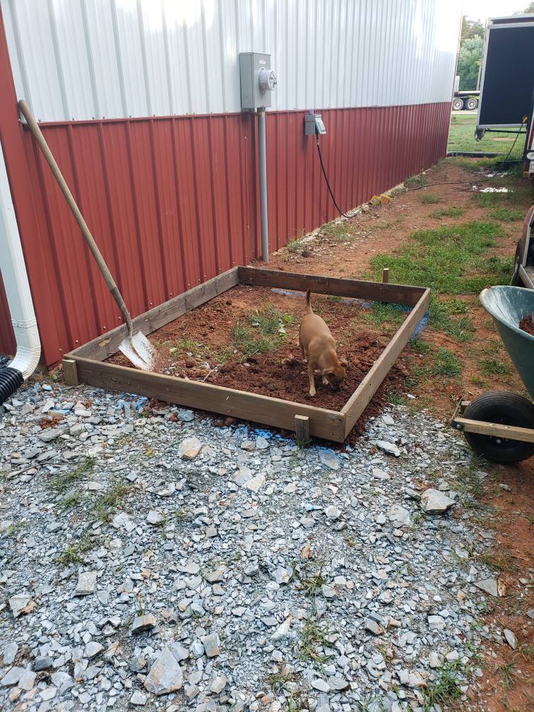

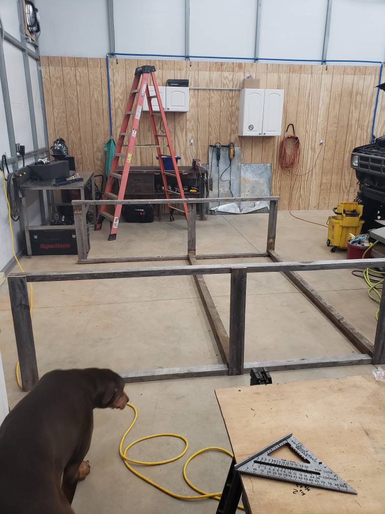

Got the frame built for the compressor shed. I'm so ready to get it outside and out of the way. Hope to get some concrete before the weekend so I can get this pad knocked put so I can get to building. I'm going to use the left over tin I have from sheeting the inside walls. I'll probably use some leftover decking material to frame it out.
Life is so much better with an outdoor compressor: I need to move mine, at least to the other side of the wall... About impossible to carry a conversation when it's running.

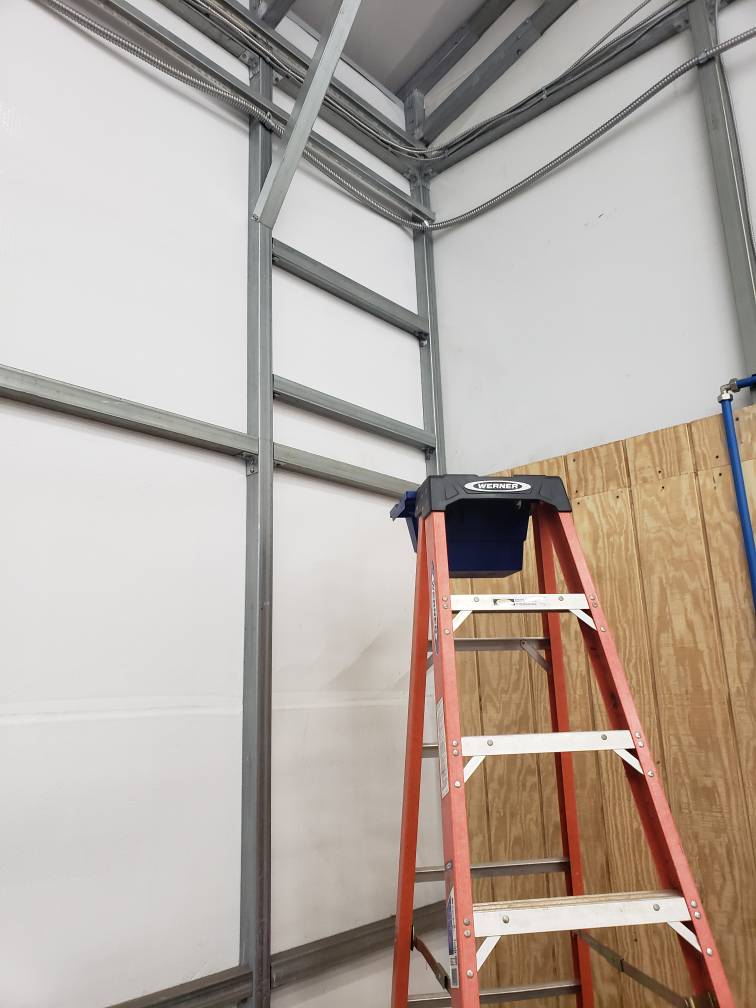

OK, tell me about the insulation... appears to be the white faced "double bubble"?
Any plans for heat/AC going forward?
That bubble insulation should thwart any condensation, right?
I'm thinking a cheap 50k+ BTU forced propane heater would do well knocking the chill off, even if most of it will go towards the ceiling... maybe a couple of ceiling fans to stir it up & assist with cooling in the warmer months?
I just ordered two 60in fans from northern tool to mount center over each bay. Should have them this weekend. The insulation is the double bubble type white one side reflective on the face out side. The exhaust fan has helped out a ton and plan on adding a second to the other end of the back wall. I've looked into to a split unit setup, but I've also got a hvac buddy that said he would hook me up if I want to go with like a 4 ton unit and basic duct work. I'm thinking that will be the way to go but I also have natural gas at my house so I've had thoughts of going that route. Even if I just use that for a heat source, it only gets used in the winter for the gas logs as we did away with the gas hot water heater.
One thing I have noted is this stuff does not like welding light. I have a friend that has a metal building with this stuff up and after a few years of welding on various projects the white layer is starting to fall off.
Yea that is one of my fears reason for covering the first 8.5ft around the perimeter of the shop. Really hoping the ceiling will be fine, if I have to go back and sheet the ceiling it's going to be a pain in the ass for sure. The guys that put it up did a good job taping the insulation together but I imagine it will fail down the road.
