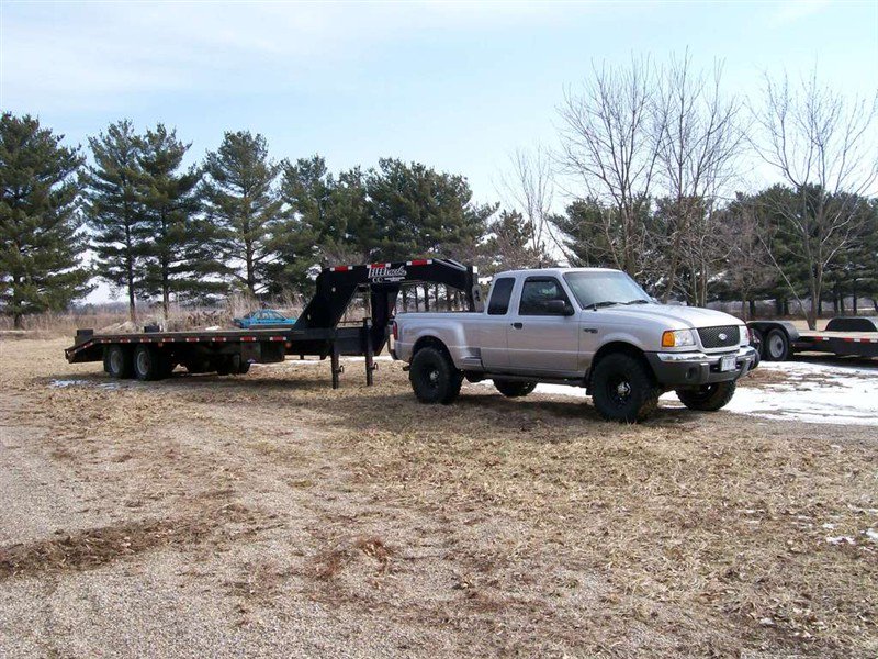

So I found one I'm 99% sure I'm gonna buy if I can get the funds. Quick question though. It weighs a little over 1,000 lbs. Will I be fine pulling it with my little regular cab Ford ranger 2.3 4banger. I have a Polaris ranger that I've pulled several times with it and it seemed to do fine. And also, does anyone have any stumps they want ground? I need some work if I get this thing lol.

It'll be fine, I've seen those Rangers pull way more shit than they should.

manual trans no problem.....auto just leave it out of overdrive and let it eat.

Clearly you are not Hispanic.

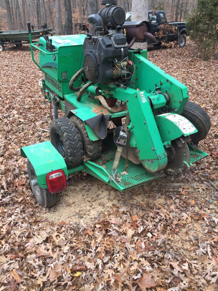

So I'm going to pick up my new to me stump grinder Tuesday. Now I'm in the market for a good strong saw to flush cut the stumps if they need it. I want something I can rely on when I need it to work. Which has me kinda leaning towards buying a brand new saw so I don't end up with somebody else's troubles. I'm not at all against buying used, just don't wanna get shafted. I've stopped and two dealers and both recommended the Stihl MS-362, which I think is the entry level pro series "big" saw. Any recommendations?

For stump work , I'd personally go bigger ...most guys stump with a minimum of a ms660...cause first thing you know ,you gotta grind a 6 ft stump that needs cut lower ...I'd be looking 395xp ...and a couple of bars....and a bunch of chain...

MS362 ain't enough saw for stumping. Minimum I'd recommend MS461 (or used 046/MS460). Personally I think the 461 with a 25" and 36" bar is the best all around saw for a 1 saw plan for now, and then once you make some good money with the grinder, find an MS880 or something. And Stihl or Husqvarna both make great saws, so pick whichever feels better in your hand.
