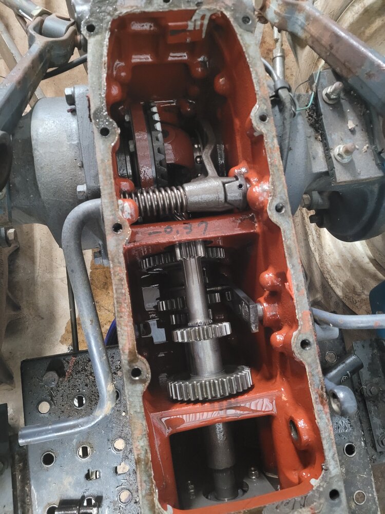

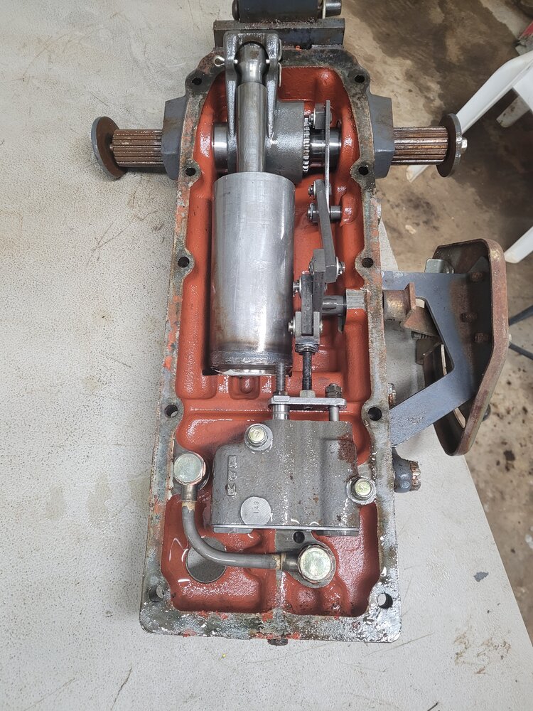

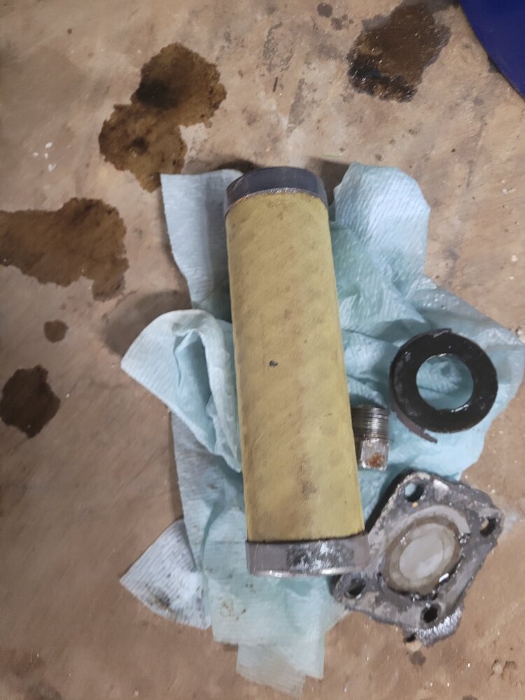

Well nothing jumps out as an issue, fluid is clean and clear, filter was clean, no broken linkage. Starting to think the pump went out
