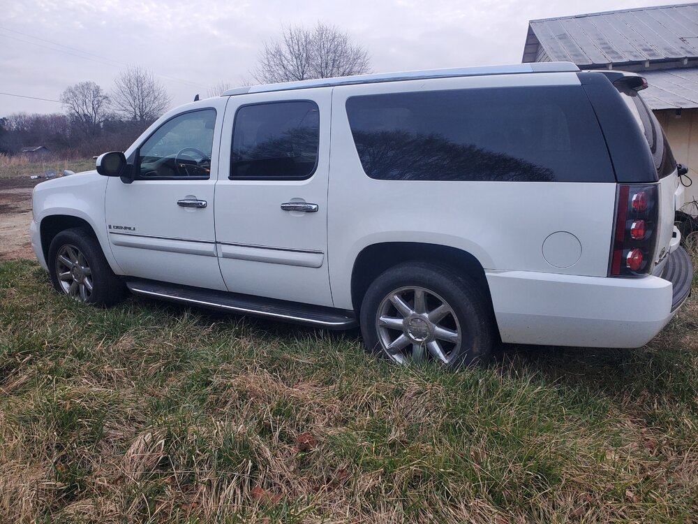

Here's some crappy pics of it. We are picking it up Monday and I'll get some better ones.
Here it is.
