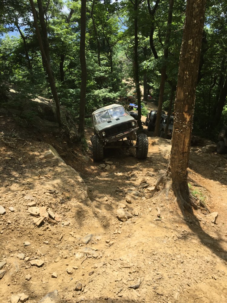

So on steep climbs I really need to pull the front end down I think. I had a harbor freight ATV winch mounted to the unibody rail but it got destroyed. I've always thought it would be nice if the front hidden winch could be used. But I would have to pass the rope through the aluminum fairlead. The only way I know of doing this would be a removable hook. Is this a bad idea and what other options are out there?

Just in case you don't know what my shit box looks like.......

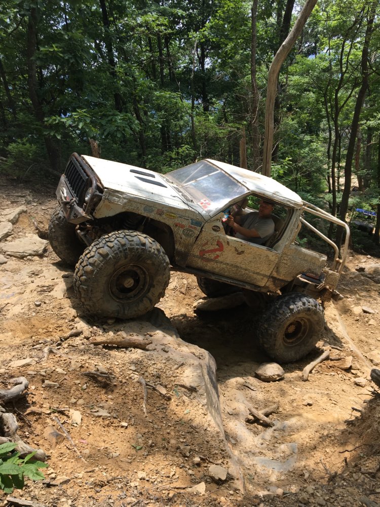

When I say steep I mean like the waterfall at rail bed or big ledges that put it near vertical. Not much you can do about that as far as I know. A rebuild is planed but not until I have something to wheel...... Yea those Factor things are high dollar.....

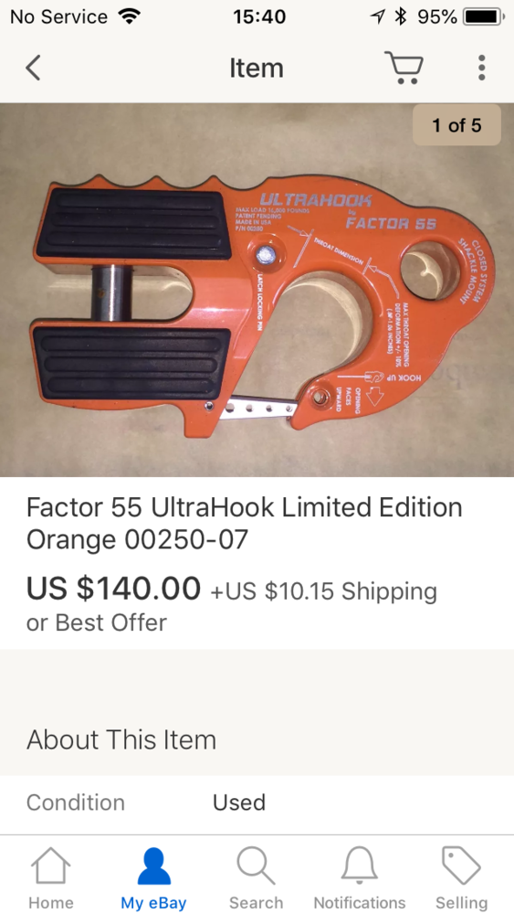

SHIT!! Lost a bet with eBay and now I’m the owner of a slightly used UltraHook. I thought 100% this dude would reject my offer.
