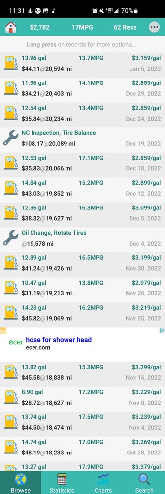

I'm pretty OCD about tracking my fuel mileage, and was surprised to see a significant drop in my Jeep JL Wrangler Rubi, 3.6L V6/automagic tranny. I bought this used last year, been getting 16-18 mpg consistently regardless of hard/soft/no top, doors/doorless and with/without rear seat. Of course I'm ignoring Uwharrie trips where i do see a mileage drop.

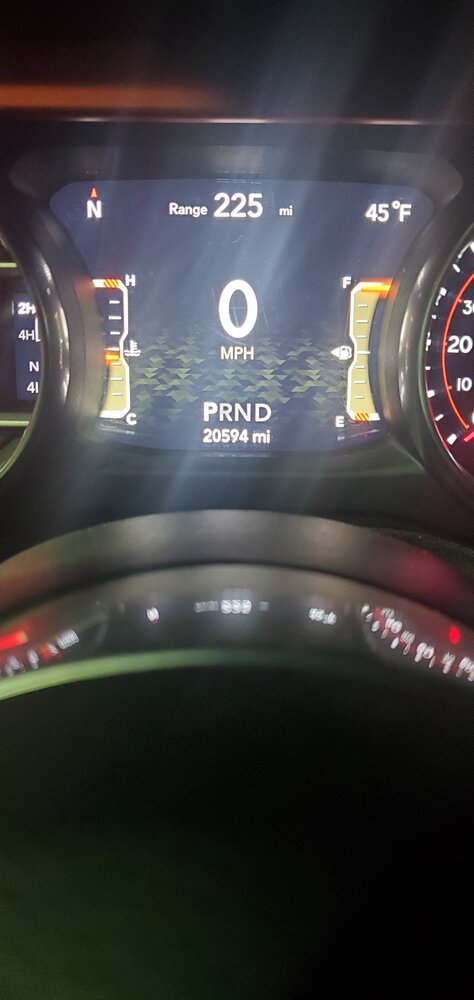

So typically the dash shows 300 mile range after each fill up. Dec24, I was shocked when it showed just over 200 mile range, and my mileage tracker confirmed 13.4mpg for the last tank. Coincidence or not, I had NC inspection done Dec19, and at the same time, had them balance the tires. 2 weeks prior, I had rotated the tires myself and noticed a vibration above 65MPH; the tire balancing seemed to help, vibration was gone and I was happy. I can't imagine anything there that would've caused a this fuel mileage drop.

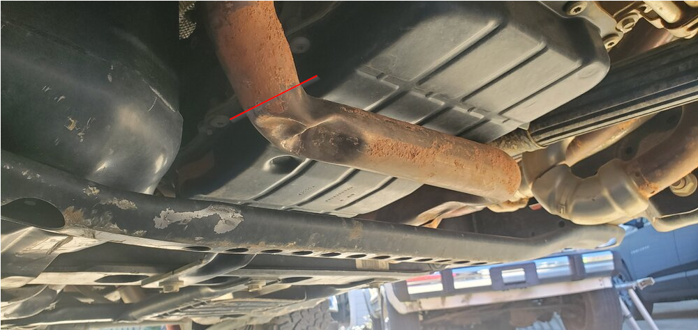

More info to muddy the waters...Thanksgiving wheeling trip, I pinched the RH exhaust downpipe. I think the engine has a littel stumble at idle due to it, but it didnt seem to impact fuel mileage thru December. I have a replacement pipe ordered, hopefully this is the culprit...but I'm not too optimistic.

That app is called aCar, been using it for a while,. Seems OK, way better than the old 'write it on receipt and enter into Excel later' method. If I was more OCD or less lazy, I could enter the gas station info into the app; I leave it blank.

These new fangled vehicles make it impossible to ignore tire air pressure. The Jeep JL has a crazy high recommendation of 37psi (I presume to inflate the fuel economy rating), and the annoying TPMS light comes on at 32or33psi. Dash screen #2 is one button press away to show the tire pressure at all 4 corners (unless pressure is low, then it will pop up with an audible ding).
