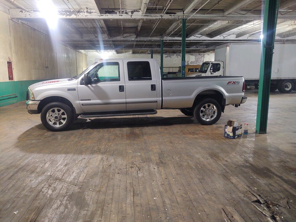

I just put some newer superduty wheels on my 2000 and at full turn they rub on the leaf springs, what size spacer is everybody using, I got a leveling kit on the way

I am running 2" spacers on my excursion from Titan Wheel Accessories. I called to verify thread pitch and wheel stud grade and the guy was super helpful. They did have 4 spacer kits when I bought, it may be worth a call to them to see if they could set you up with all 4 as a package?
