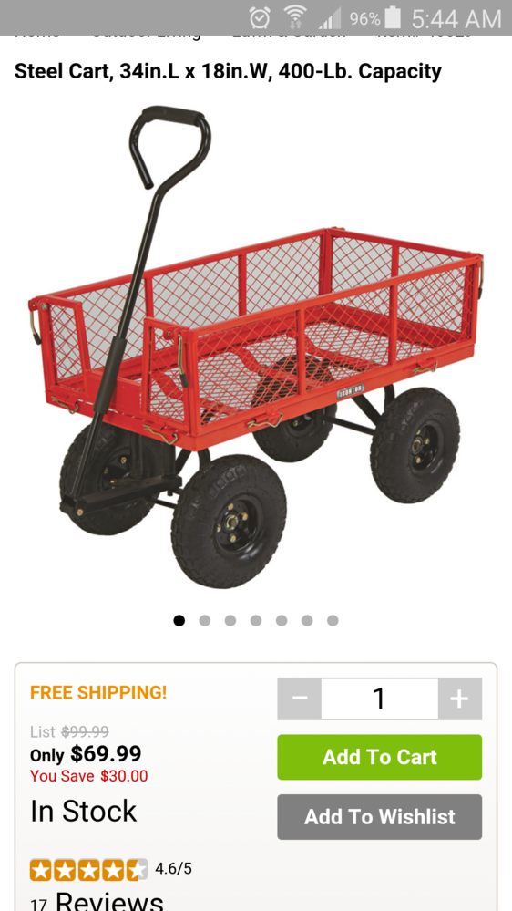

We use one of these . Then we have rod holders run down the side. Screenshot_2016-02-04-05-44-51.png
^if I were to get another one, this would be my route.
I've had multiple carts and this would be my choice if I were to do it again. Plus, it's multi purpose.
