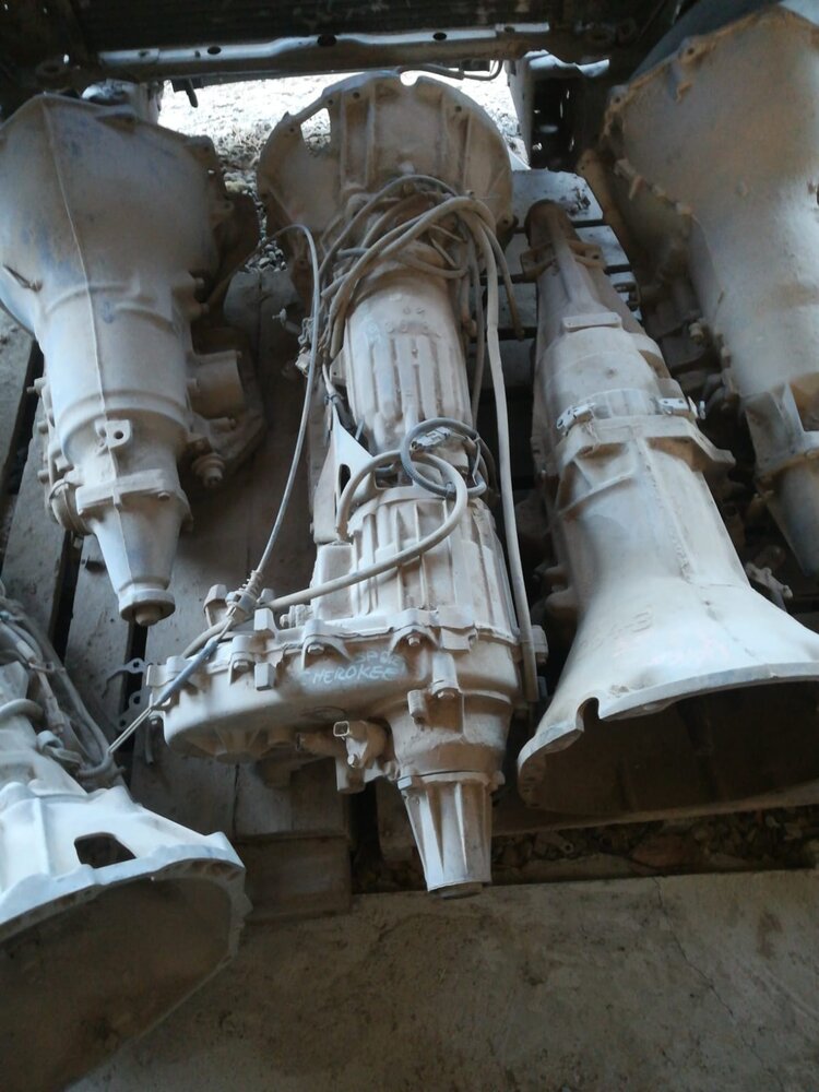

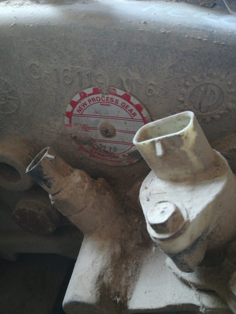

I have a 2001 jeep cherokee want to make the conversion to 4wd and I found in a junkyard apparently a 1995 aw4 transmission with a np 242 transfer case, it would work on my jeep? Help

You'll need a 98-01 aw4.
This thread has all the info you need about the aw4.
I've done the 4wd conversion a couple times, it's pretty easy.
